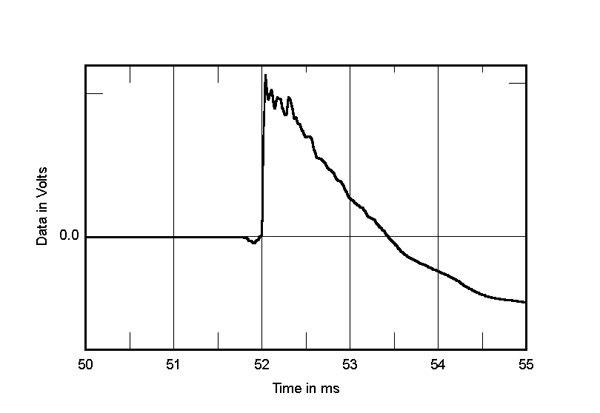

Now the issue with speech clarity, is in my view very much an issue of phase/time shift in the speech discrimination band, and high Q bass interfering with the former. The lobing pattern of horizontal MTMs is also a significant issue. I have done my own investigation of this, and I know it to be true. Not a may be, but certain.
Now take a look at this active KEF lsx review. In particular look at the this superb step response, entirely due to imaginative use of DSP.
So I can tell you without hearing it, that speaker will have superb voice clarity.
Now in terms of hiding subs, TLs actually come into their own here, as they can be designed very slim. The 10" driver in my in wall system fills that huge space with deep bass without difficulty. You would think there were at least two 15" drivers, or may be more. You might have trouble believing that, but it's true.
So if you geared a system along those lines it could be made for both discrete in wall, or free standing systems. The DSP would make it easy to adapt the system to any application. What I mean is be able to correct for in wall, free standing or other without design changes. With high grade components systems could be made user friendly and give long reliable service. I actually suspect that a system on those lines would work just as well as 2.1 as 3.1 providing further cost savings.
