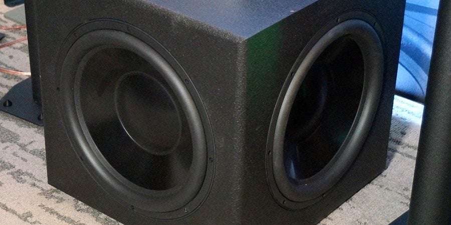

I don't understand why Dayton did not use their RSS390HF-4 subwoofer drivers instead of the RSS390HO-4's in their enclosures.
The HO version which they use is for Automotive applications and for small cabinet use in small rooms while the HF is for larger rooms and can be used either in a seal or ported cabinets and is for Hi Fi use.
In my opinion, the HF version is closer in design to the other subwoofers which were shown at the Axpona exhibition.
Did you see the size of that enclosure? The primary reason to use PR’s is with drivers suited to small enclosures. Ports would add so much volume to the enclosure it would defeat the purpose. They wanted to offer a high output subwoofer in a small form factor and the HO is better suited to that.
However, the use of PR's doesn't have to be limited to drivers suited to small enclosures. I agree in that an enclosure for the HF version would have to be substantially bigger than for the HO model. But you need a rather large listening room if you want to drive those subwoofers to their linear excursion limits, and cabinet volume is less of a concern.
Yes but there is no point in using a PR when a port can be used. They are Lossy. The PR developed by Dayton is HIGHLY lossy. A PR is a suboptimal port, so why not just use a port. If the enclosure is already large you can make a better sub using an optimally designed port. The PR can’t compete.
I agree with you here. According to Vance Dickason, PRs have two important advantages over vents:
1. They eliminate vent colorations (such as resonant pipe sounds), wind noises, and the internal high frequency sound reflected out of the vent.
2. As already discussed, they are practical for small enclosures which call for vent lengths in excess of internal box dimensions.
On the downside, PRs have a steeper cutoff, less transient stability, a slightly higher cutoff frequency, and greater overall losses (Qt) than vented designs.
