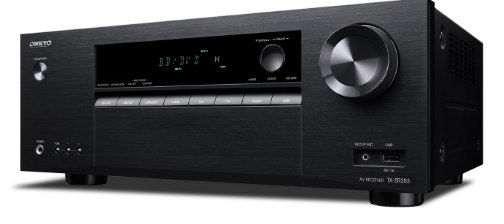

The TX-SR383 AV receiver from Onkyo provides a choice of native 7.2-channel soundtrack reproduction, or a 5.2-channel surround-sound layout with powered audio distribution to a pair of stereo speakers in Zone 2 . Rated at 155 W/Ch it seems like an amazing deal for just $400! Read on to find out why the devil is in the details and you may not be getting all those watts you think you are.
