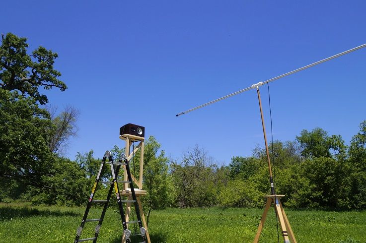

Not using the term loosely. I use a DIY spin-o-rama device, you can see it in some of my past bookshelf reviews, such as this image from this page.

Yeah, you are thinking of Harman's shuffler. The 'spin-o-rama' is where responses at every 10 degree angle on the vertical and horizontal axis are turned into curves that have predictive value. It has been adopted by the consumer electronics association as their measurement standard, the CTA-2034 standard. There is some good info about it on this page, in particular this image. It is explained in depth in Floyd Tool's latest edition of Sound Reproduction, the third edition.
