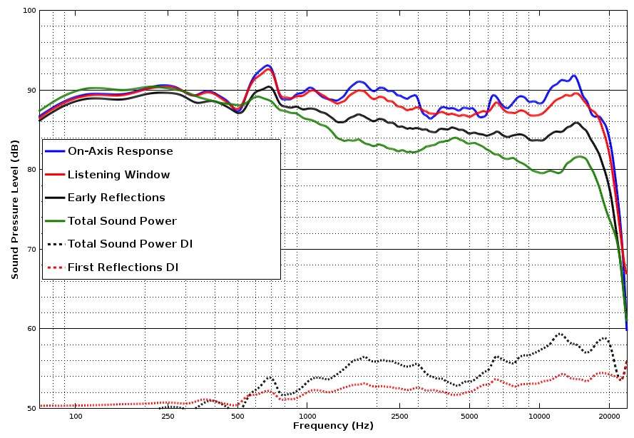

@shadyJ Great review as usual. Curious on MP's K-bas vs Dennis's AAs - yes - later lack some of low end bass, but otherwise they measurements is noticeably flatter afaik

Thank you Bored. Comparing the K-BAS graphs to the Philharmonic AA graph could potentially be misleading. The reason is I am using a larger Y / X scale, and this will exaggerate ripples more on my graph, so my graph is a bit more unforgiving. You have to keep scale in mind when comparing the two. Also I am using minor grid lines in my graph and Dennis is not, and that may seem to accentuate non-linearities in my graph when comparing the two.
100% agree, only to the opposite of what you're saying. You've used more forgiving 50db scale while Dennis posted much less forgiving 35db scale
Now, there could be some smoothing going on, but by the looks of both plots neither are heavy handed.

I don't mean to say scale by dB, I mean scale by ratio of graph dimensions. Dennis is using what looks to be close to a 2 to 1 ratio of x vs y, whereas mine is not quite 1.5 to 1, so the Y scale is much more stretched out. This will magnify any ripples or ruggedness.
Also, it looks to me like Dennis has 45 dB represented on the Y axis, not 35 dB, so his dB scale should be pretty close to mine
Ahh, Image scale. Gottacha. Here's both graphs merged to same (or very similar) scale to the best of my very humble gimp skills.
Dennis Murphy
Thanks for going to the trouble to construct that comparison. All I would add is that my graph is completely unsmoothed. That's why you see so many minor jagged deviations that would disappear with the degree of smoothing used on the Audiophile measurement.

@shadyJ, I really like the way you presented the graphs - especially the two angles of the horizontal off-axis response. I wish more people did this! And nice write up too - thanks for thinking out loud over the measurements!
Thanks!
Thanks!
Thanks. One thing I am proud of about this review is- to my knowledge- it is the first time the full suite of graphs used by Harman and CEA-2034 style presentation has been done for any speaker review. This involves taking 70 sweeps, or a sweep for every 10 degrees all around the speaker on both the horizontal and vertical axis, and then processing them to achieve those curves.
I also appreciate all of the thought and effort that went into the measurements. However, I'm still a little puzzled by the "Total Sound Power" plot. Is that the one achieved by taking the 70 vertical and horizontal polar plots? If so, is the resulting composite just the unweighted average of all the plots? Or is there some algorithm applied that takes into account what is believed to be the relative importance of each plot? If it's the former, I'm not sure what we end up with, since the ear certainly doesn't process all of these off-axis measurements equally.
Hello Dennis,
From the CEA-2034 standard:
"Sound Power
The sound power is the weighted rms average of all 70 measurements, with individual measurements weighted according to the portion of the spherical surface that they represent. Calculation of the sound power curve begins with a conversion of SPL to pressure, a scalar magnitude. The individual measures of sound pressure are then weighted according to the values shown in Appendix C and an energy average (rms) is calculated using the weighted values. The final average is converted to SPL.
Sound Power Directivity Index (SPDI)
The the purposes of this standard the Sound Power Directivity Index is defined as the difference between the listening window curve and the sound power curve. An SPDI of 0 indicated omnidirectional radiation. The larger the SPDI, the more directional the loudspeaker is in the direction of the reference axis."
