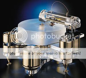

Just for the record my linear tracker looks nothing like this linear tracker:
