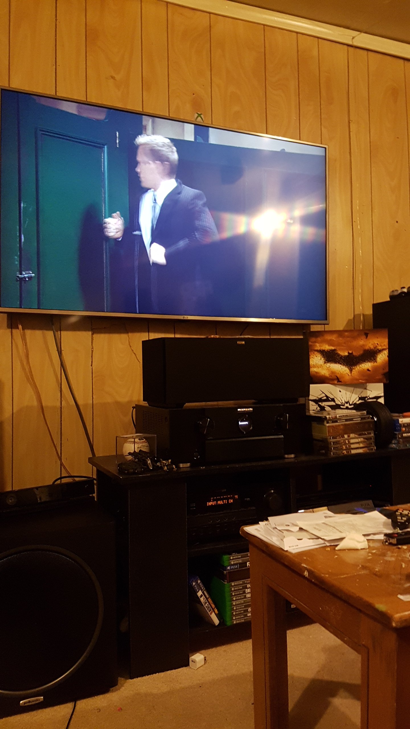

The 80hz I suggested is for your L/Rs, it's a preference thing but with your sub you may well do better with a lower xover, you can try 40, 60, 80, 100, etc. Leave the others alone. Your center is set for 150? Got a pic of your speaker placement?

oh okay I can get a picture for the center speaker
Doesn't look too unusual. How did you position your Audyssey mic? Use all positions? Might just want to try re-running Audyssey....
