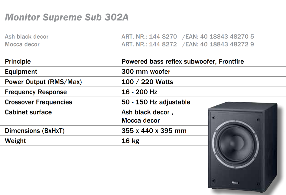

That subwoofer, is it a 303A or 302A? I can find the latter but not the former. I ask because I suspect you might benefit upgrading your subwoofage.
*Edit:
Oh My bad! Yes 302a is the one, and an upgrade will help for sure.
I'm actually considering DIY Right now I have a 12" driver from sb acoustics and a 300w plate amp on my shopping list, which should get flat to 19hz for about half the price of a pb1000 here

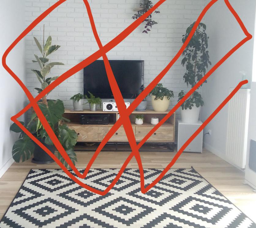

One of the toughest parts of this whole setup is being stuffed into that little cubby. Unfortunately I don’t know any easy way to deal with that. I think I would move it all to the front even with the mains. Then use some absorption/traps/duffusion etc behind it all. It saying to NOT upgrade. But that room is not helping at all. And if possible, some kind of positional help would go a long ways.
I was thinking the same, but I give Opie props for pulling the mains forward and not stuffing them in the cubby too. It looks like at least a little effort and consideration went into placement.
You're right tho, those cubbies are not very speaker friendly at all.
Opie. :wink:
Yeah I agree. I can see some thought definitely went to to that. And was really surprised to see those mains way out there. Probably the best thing to have done so far. It’s really really tough with those spaces. Some spaces can only give so much…
Thanks for the feedback and yeah I agree entirely, initially I had bookshelves all the way on that front wall, but when I upgraded to towers I took the opportunity to pull them out to where the screen sits. I still get some dirty looks from the wife about that lol.
What's worst and is hard to see from the pics is that there is about 8 meters between the back and front wall, so before I pulled the mains out there was literally no soundstage separation between left and right.
The one option I broached was to flip the room and have the sofa in the cubby (or half in), but that would involve a lot of work and throw out the projector and screen distances so is off the board for the time being.
I think the best middle ground I can hope for will be to get some sound treatment into the cubby on the walls. I'm already halfway through swapping the sub to the left side, which should help a bit (judging from some initial measurements I've made)
Edit: Or if manage to get the sub(s) out and by the sofa (or elsewhere depending on testing) that should leave only the center back there, which will be an improvement right?
