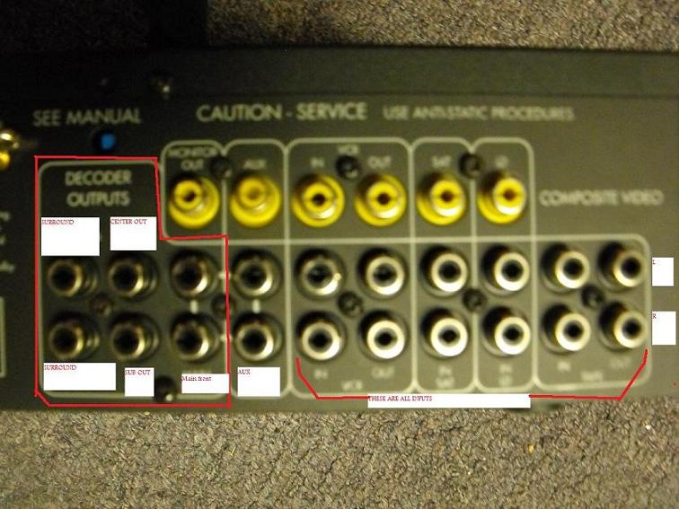

How do I hook up my preamp and power amp?
I want to use the Arcam Zeta 2 as a preamp and then use a 2ch power amp(UPA-2) to run a two channel stereo system. Is this possible with the Zeta 2? (limited cash and the arcam is free)
I have speakers and a 2ch poweramp in a few days.
To do this Im guessing I would:
1)hook my cd player to the AUX input on the arcam,
2)hook the "main front decoder ouputs" on the arcam to the inputs on the power amp (emotiva),
3)hook up the speakers?
Am I on the right track?

I googled, and I believe it is actually spelled Xeta 2. Not too much info after minimal browsing, I even found a pic of the back but it's small and low rez I think. Can you post a pic for us, or find us a link for a manual? Help us help you. ;)

Here is a pics of the back of my Xeta 2

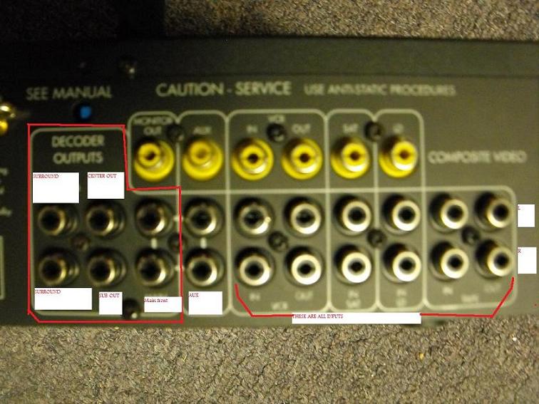

Here is a pic, to me it makes sense that Id use the decoder "outputs" for the main fronts (LR) at attach these to the inputs on the 2ch preamp Ill be using...
but Im just guessing and I cant find a manual for this amp...
Thanks for any help.
mibson
Thanks for any help!View attachment 7870
Sorry, I should have said:
"Here is a pic, to me it makes sense that Id use the decoder "outputs" for the main fronts (LR) and attach these to the inputs on the 2ch power amp (Emotiva) Ill be using...""

I suppose it would be either those . . . or maybe the "AUX" right next to them? I really don't just how old this thing is, but I really really advise finding a manual somehow. Or at least finding other OWNERS who can help you. Or at the very least, experiment and look around all of the menus.
My guess, based on very limited time in this hobby, would be that the processor can apply some sort of old skool matrixing algorithm to a 2ch source . . . and what you might want to avoid, depending how the matrixing is done, is having only the "stereo part" of the "five channel output".
IOW, I just want you to be sure you are getting the true 2.0 stereo in full. There are probably extremely high chances you will be already, but that's just the paranoid side of me. Good luck.
Or maybe instead they are just pass thru for SACD/DVDA. Yeah. Just something like "decoder" makes me wonder.

I am concerned about these "decoder outputs" and getting true 2.0 stereo...
I should also explain this the above picture does NOT show the speaker connections for the center channel and rear surrounds. So my understanding is that this amp was intended to be a preamp for the mains, and an amp for the center and surrounds - it is really perfect for me if I can get true stereo...
I have tried to get the manual from my brother but that will happen after I get my speakers...
The amp is about 10 years old and has dolby prologic, and stereo modes , I dont mind because I really just want to use it as a stereo preamp for my power amp.
