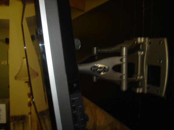

Omni Pro articulating mount/ $300

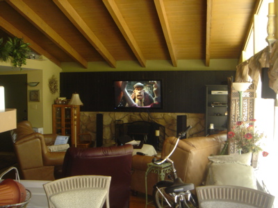

Im officially in love with my new system. I used the YPOA feature on the receiver and now my HT sounds so nice. I am pretty stoked right now. Maybe tomorrow I will post pics.
