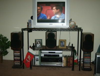

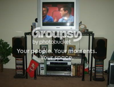

went from this:

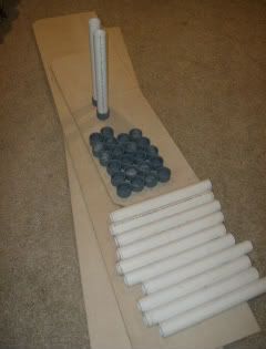

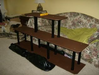

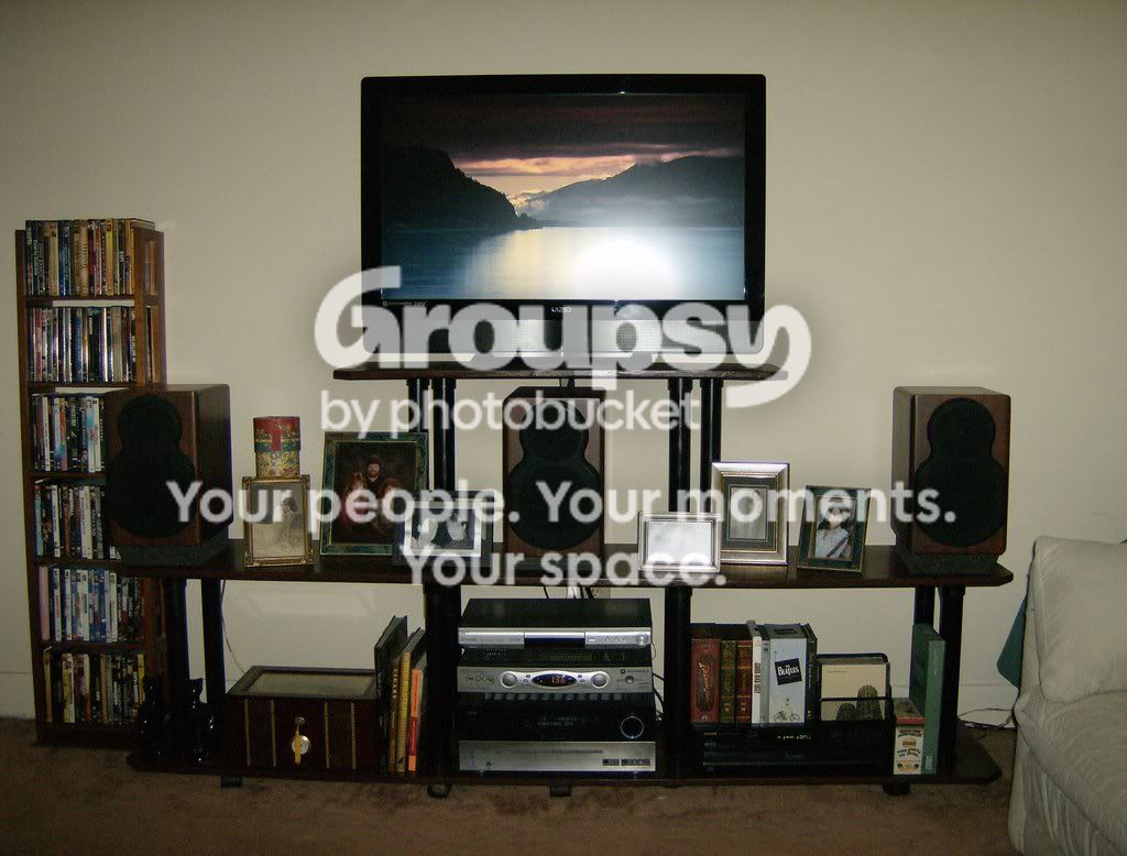

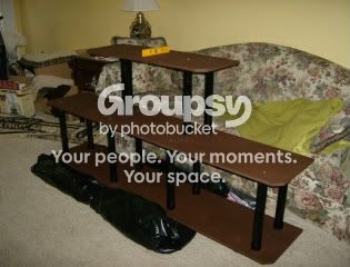

Had to "custom build" an entertainment stand to accommodate my vertical center & not being able to wall mount LCD:

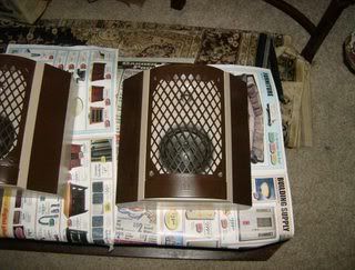

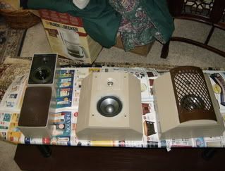

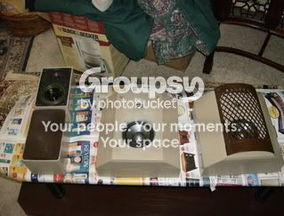

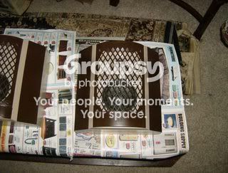

JBL Encore refurbs & "custom painted" surrounds - $55
Altec Lansing Model 21 I/O Sam's Club 2 pr special (8 years ago)"custom painted" rears - $30
Prime/Paint for both - $10

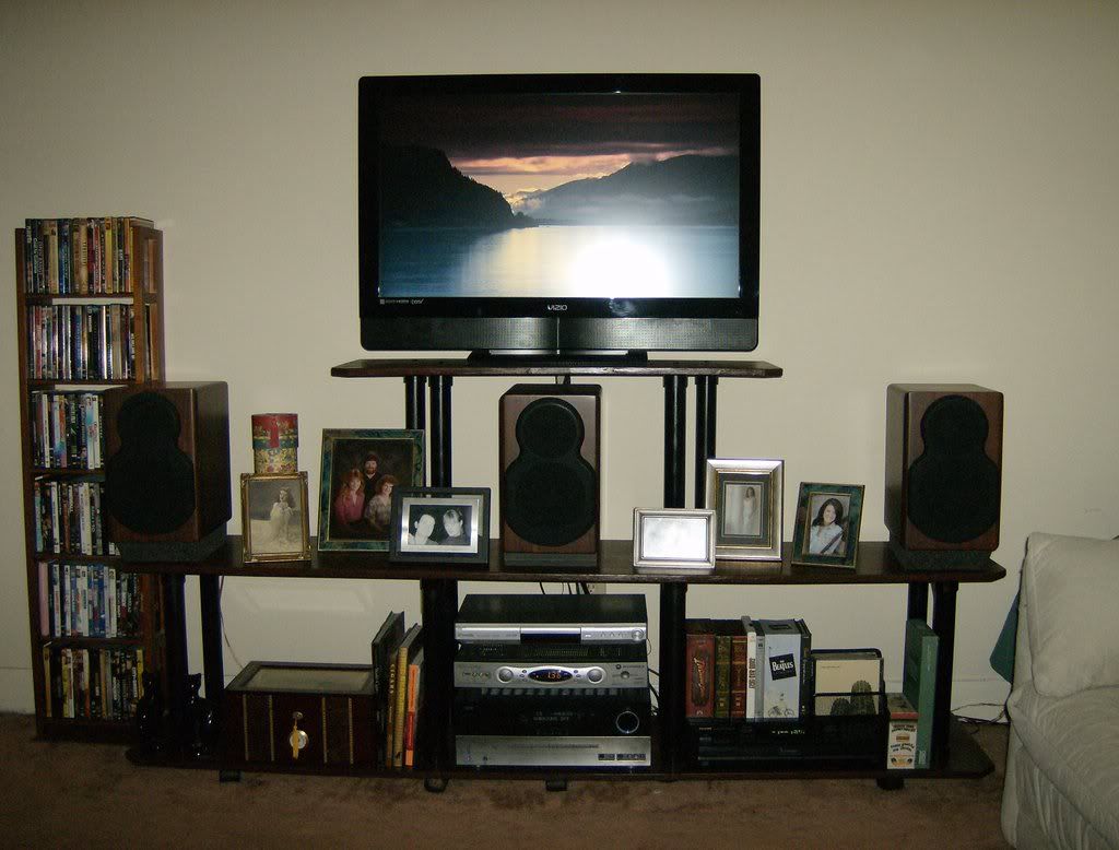

to this:

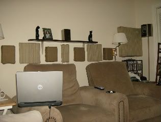

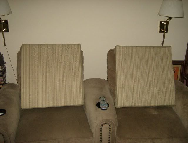

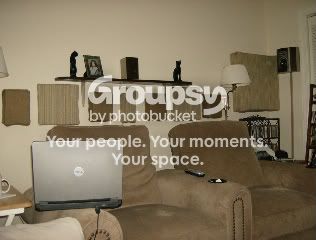

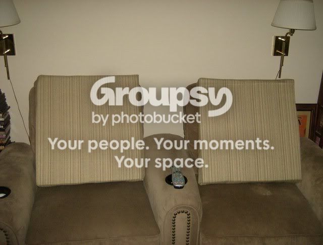

with a few "trial" DIY panels ...
2- 2x2x4" open back w/ a mixture of 2" and 4" "mini panels" .
DIY Panels Duct Board/Fabric/Hardware - $40
DIY Entertainment Center 3/4" Birch Ply/PVC/Hardware/Paint & Stain - $65

Excellent transformation! I really like your custom-built entertainment stand. That's very nice. The color goes very well with your speakers (as planned, I'm sure).
J
jostenmeat
Congratulations. I really, really dig the stand.
You really know how to stretch a dollar. Well designed layout. Just curious for future reference, would you consider building a stand like that for a fee? How much would you charge for a stand very similar to that?

Thanks! I've always messed 'round building stuff w/ PVC integrated because it is so cheap, easy to work with, and sturdy...
But I'm no woodworker by any means. I just knew I needed something affordable that would be functional - fitting my needs. I will gladly send you a cutsheet & materials needed for something of the likes. Would be tough to ship... Although, it is somewhat "modular" and can be broken-down/reconfigured without too much effort. The PVC "post" are only set, not glued into the caps. They are, of course, bolted "through" the plywood. And there was some concern w/ lateral shift. But, this thing is sturdy! And can hold a lot of weight. I just have to be cautious where I'm grasping/using force as I roll it in/out (it is on casters) when changing connections, etc... (in the midst of getting some DIY speaker cables done for L/C/R and upgrading others w/ some Monoprice stuff)

Wow! What a transformation for the better.
I really like the stand and its ability to accomodate proper speaker placement.
All three fronts at ear height!!!!!!! We have a winner!!!!!!!

Thanks!
Yeah, obviously that was the goal. :)
And I can't say enough about having matching fronts.;)
It made a very noticeable difference, raising the fronts approx 8" and spread 12" further apart (L/R). They are also "decoupled" by a urethane foam wedge.
This was a product I pulled from a point-of-purchase display from our store.
I'm using several of these around the room - some as a light weight backer to 2" duct board "mini panels" along the back wall. Also, the pvc post are stuffed w/ foam pipe insulation tubing. Does it help? Dunno, but I figured couldn't hurt & took all precautions to unwanted "noise";)
The XLS are known as a slightly laid back speaker to begin with.
Raising them to seated ear height gave me a touch more detail when just 2 channel & much improved dialog clarity when HT mode.:D I really hope we can see skiing Ninja BUDO upgrades soon. Some of my "classic rock" tracks could use a bit more definition...:cool:
I was concerned w/ the video height, especially the Vizio having such a large "frame" w/ speakers on bottom. But it causes no neck/eye fatigue & just about perfect slightly reclined. Although, I will make sure my next set - sometime after first of year (tax refund?) will have thinner bezel/frame:)
The 7.1 is likely overkill in this small room. There is some nice fill on some surround tracks though that were not there before - and my gf notices the difference. Overall, I'm very pleased w/ this system, yet, always trying to get more out of it:cool:

Very nicely done! I like the L/C/R on the same level, looks great ;).
