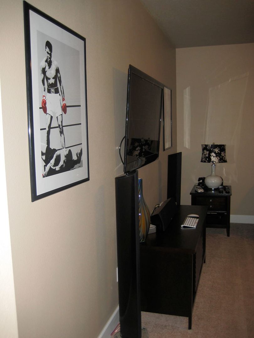

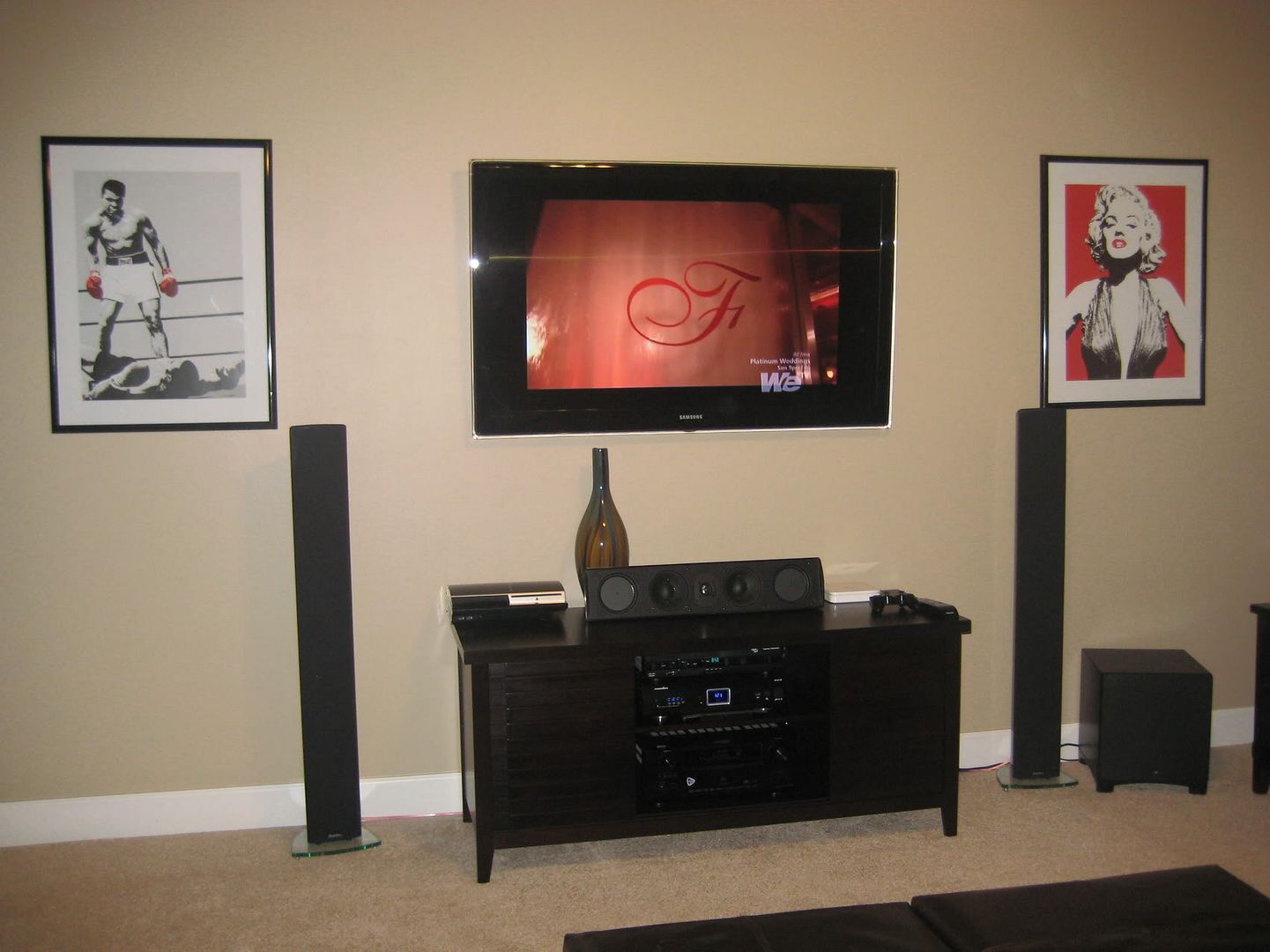

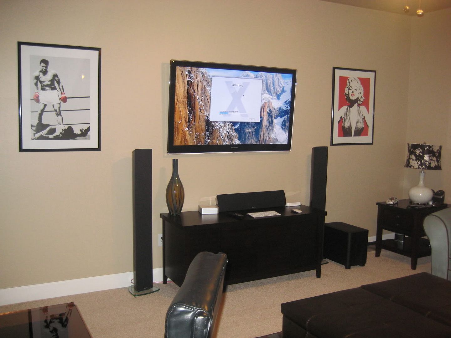

My setup for right now!
samsung led 55 7100
denon 4308ci
mythos one for l/r
mythos eight for center
martin logan abyss subwoofer
Panamax 5100 surge
samsung bdp1600
PS3,wii and a harmony one remote and a mac mini and apple airport extreme and audio-quest hdmi cables
I am saving for mythos 2 for rear's and a oppo blu-ray-bdp-80
emotiva UPA-5 FIVE CHANNEL AUDIO POWER AMPLIFIER

Looks like a great set up. I would try and pull left and right channel out wider to create a larger sound stage and better separation.
lsiberian
lsiberian
Spot on. if you have trouble hearing dialogue it's probably because the LR channels are too close to the center.

I agree just move those mains out from center about a foot and it should make for a nice sound stage. Also if you could mount the center a little closer to the bottom the screen it would help dialogue imaging. Otherwise super clean I like it!
j_garcia
j_garcia
Even just getting the center up above the stand would help with center sound. Right now it is reflecting directly off the top surface. The mains should be pulled further apart as noted and also pulled away from the wall at least a few inches, preferably more.

i moved the speakers out more and away from the wall sounds good but i dont know what to do with the sub ?
krzywica
krzywica
I would start by doing a room crawl.
Put the sub in the primary listening position and play some bass heavy music. Then crawl around the room and find the spot where the bass is the strongest, smoothest, and most consistent. Then put your sub in that position. After you do that experiment by putting the sub farther and closer to the wall to see what sounds best to you. If it sounds boomy pull it away from the wall more. If it lacks punch or volume move it closer.
