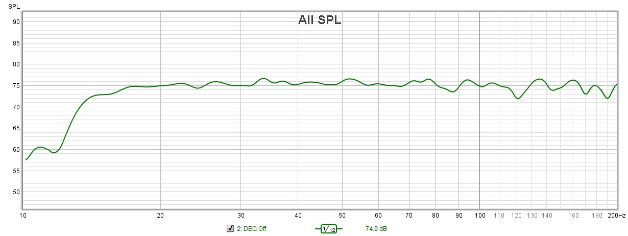

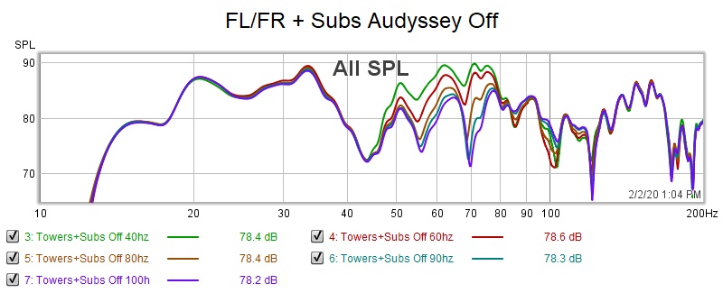

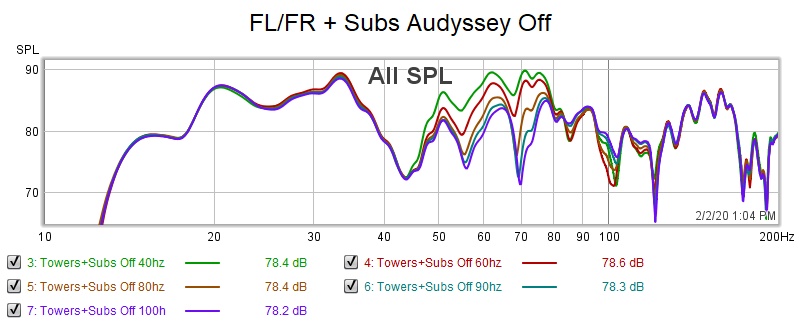

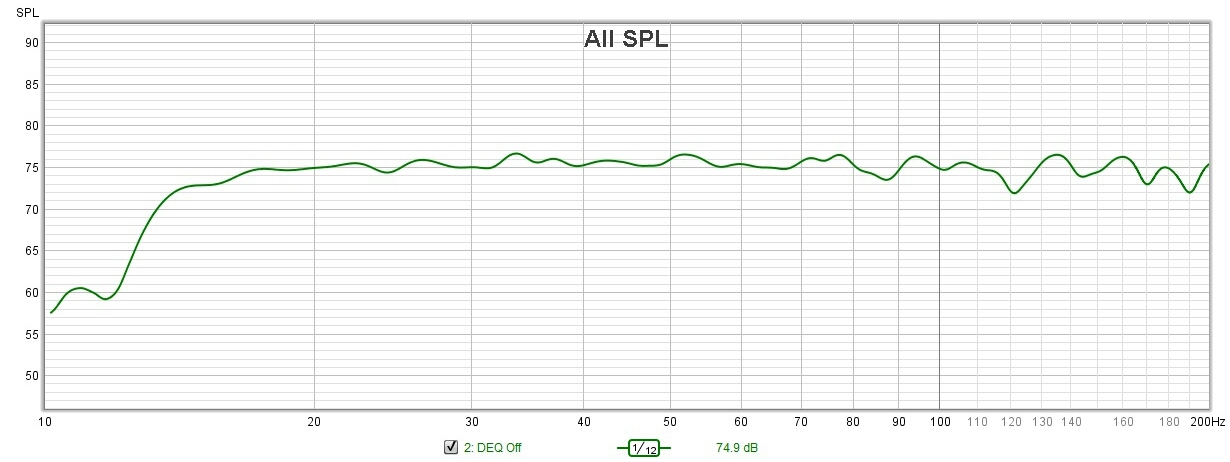

You can copy Audyssey "Flat" to manual eq and adjust on the fly just like Yamaha. The editor app is if you really wanna get serious about it and make precise adjustments, ideally based on measurements taken with a calibrated mic. My bass right now is +/- 2 dB from 115 hz all the way down to 16 hz using the app.
This is what it started with.
It's an older sweep, but still accurate for my room.

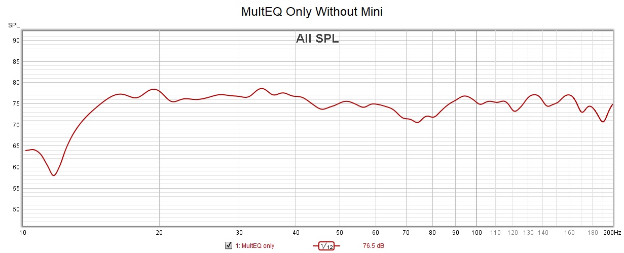

As far as just running setup and not touching anything goes (except crossovers and large to small speaker setting- something you'd want to check for any brand) I think Audyssey does a great job in my room.
Look at that "before" chart and compare to this.
That's where Audyssey got me all by itself without any tweaking. It's not perfect, but that's pretty durned good for what I had to start with. It sure made the tweaking easier to do.
At a glance, that looks almost identical to your finished product one above, except for the low end.
