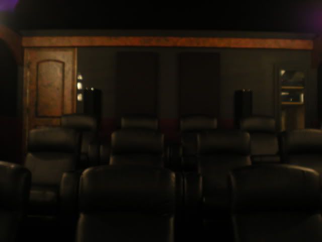

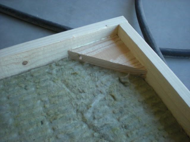

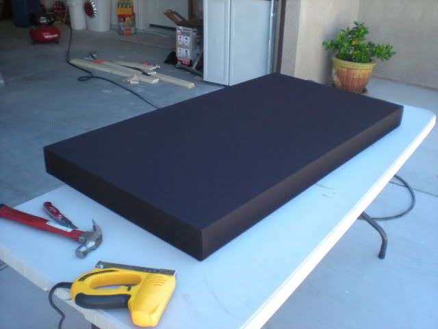

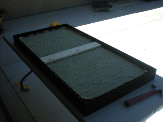

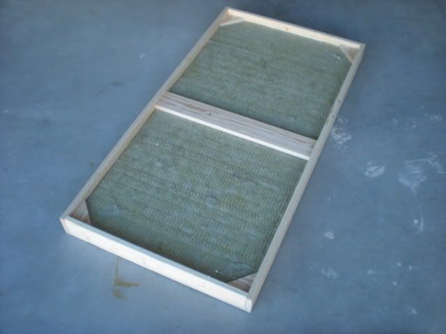

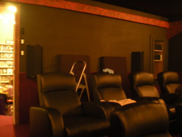

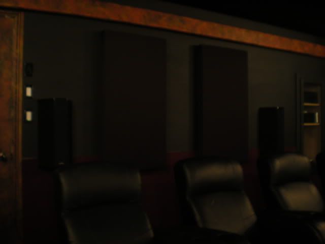

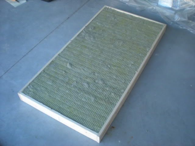

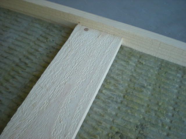

Look what I built today. WooooHooooo I can believe how good these work. I tried the yell at the wall test before and after and I have to say WOW. Its like it just sucks in the noise! I cant wait to do all the walls and I'm going to try and do most of the ceiling as well. I noticed that when I stand in the center of the room and clap really hard, I can hear a slight Twang after the clap, So I know this room needs treatments. These panels are full size 24" x 48" 4" deep. I covered them in a Dark chocolate stretchy grill cloth. I love they way they look! :D

Oh yeah and FYI, The wife came in the theater and "Oh ....those look nice" So they passed the Wife test.

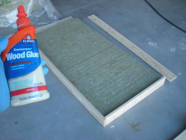

Here are mine prior to mounting:

My project for the next week is to also build some room treatments. I got some 3" leftover rockwool from a local place for dirt cheap. I've just been using the bare insulation for experimentation and I already notice a huge improvement. What type of fabric did you use?

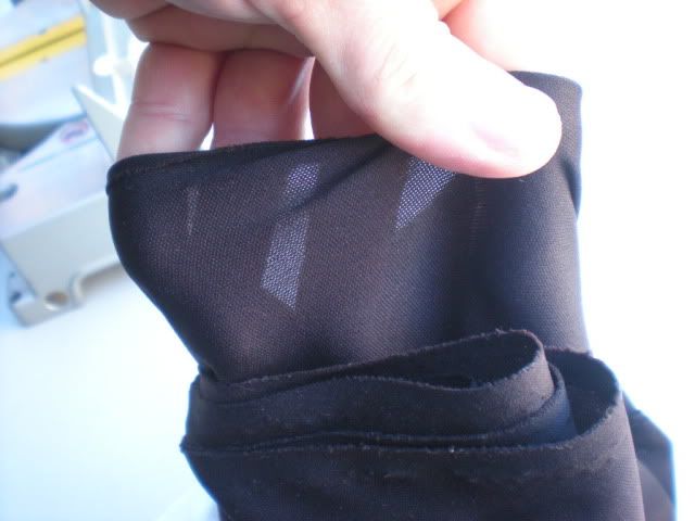

Thanks!! :D For the fabric I used grill cloth. I got it at Walmart in the fabric section. It was $1.97 a yard. It's nice and stretchy and as you can see from that photo it's really sheer.
Those look great, Where are you going to hang them?

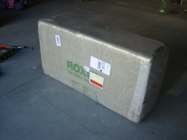

If you don't mind my asking what type/grade is that Roxul, where did you order it from and how much did it cost?

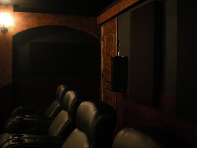

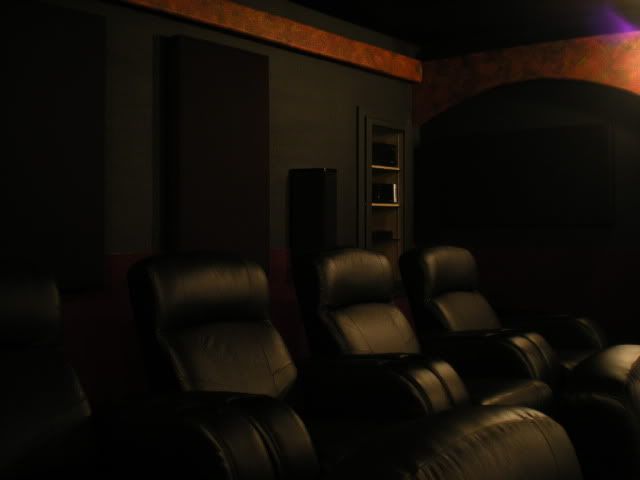

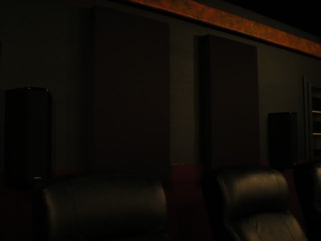

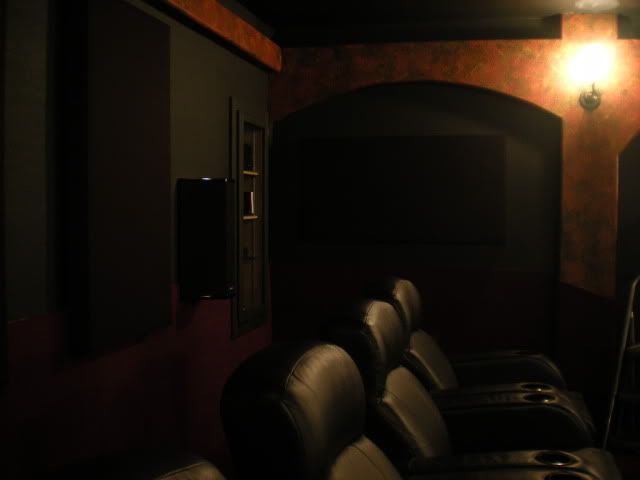

Well I got back out in the garage and built two more panels the same size as the first two. I placed these on the rear side walls. I turned them sideways so as to cover most of the coves. So I now have 4 total so far.

That truly looks great. Excellent job on the panels and HT.
just-some-guy
just-some-guy
indeed. i would love to hear/see that room :cool:

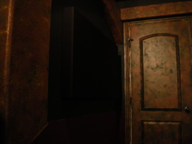

i could really use that brown color/pattern on the walls.
how does that do with the light from the screen ?

Are you talking about the paint on the walls?
Any info you can provide?
