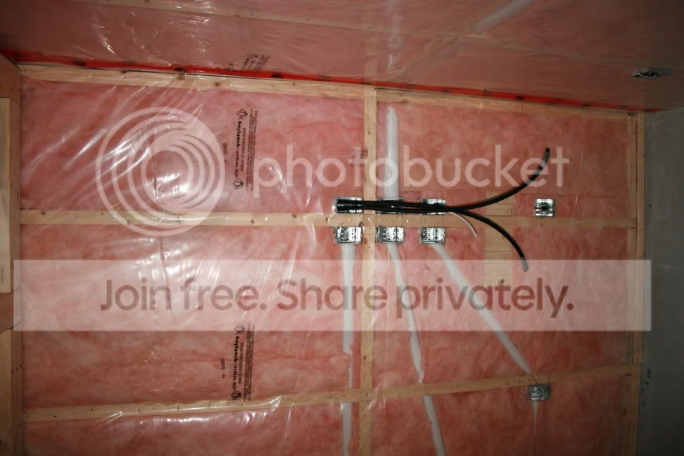

I used 2" PVC for wiring conduit throughout the room. All speaker wires, HDMI and sub cables will be ran in wall.

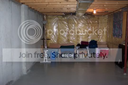

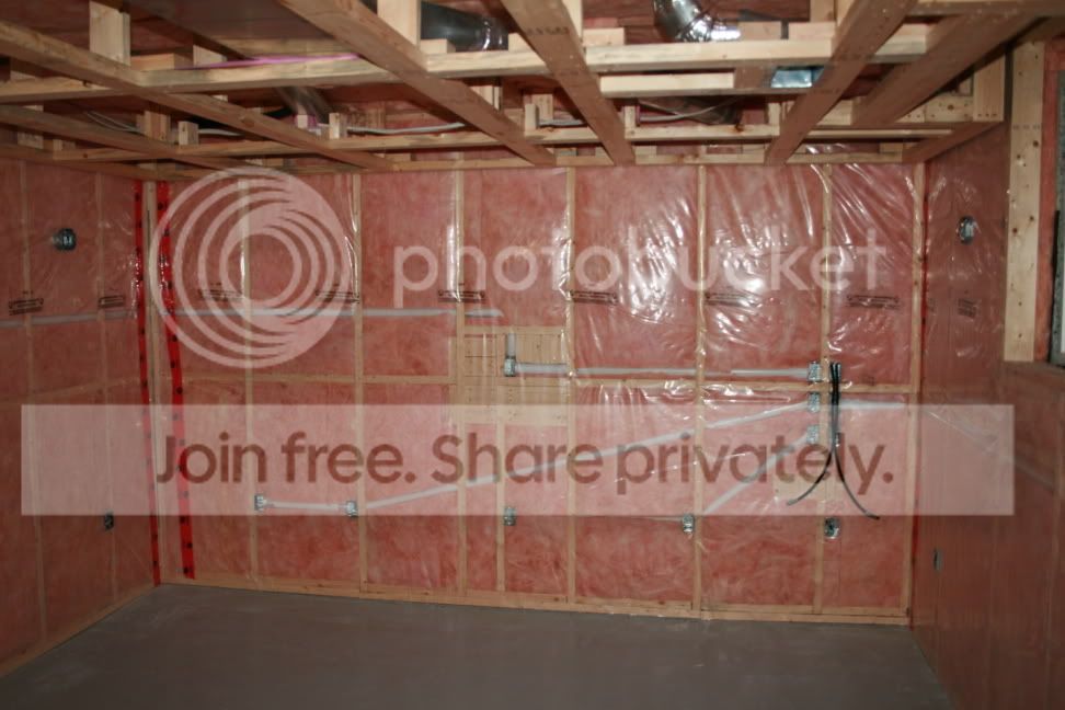

To start, here we have a picture of the basement just after I bought the house and before I started tearing all the old framing and insulation out... the original builders did a piss poor job on the framing and insulating, I had no choice but to tear it all out. Note the duct work I mentioned above with the split in it.

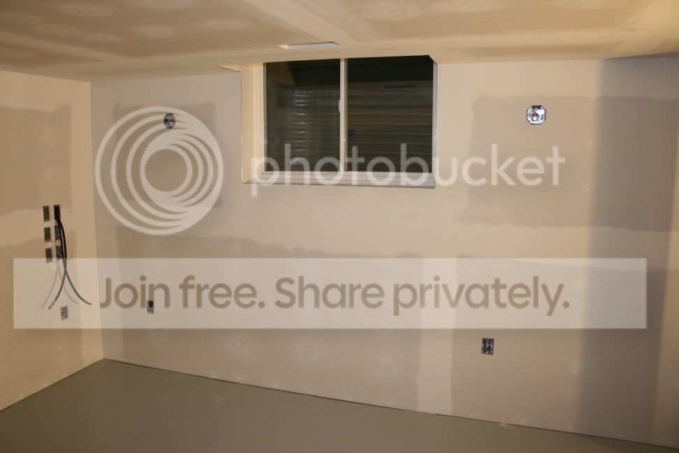

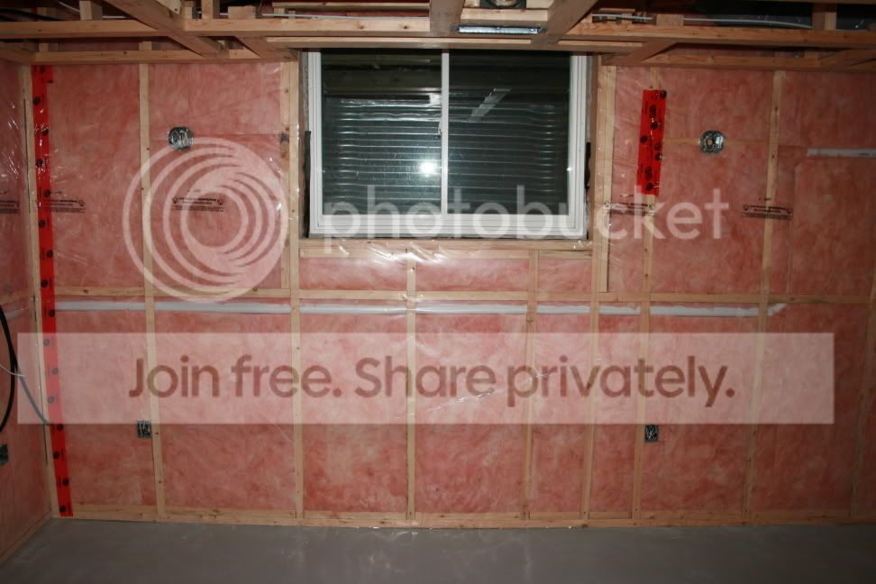

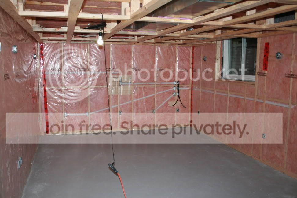

Here is a picture of the same far wall you saw in the first picture, but after I reworked it. It is the wall where the TV will be. You can see the section of blocking I mentioned above, with a conduit into the middle of it for the HDMI cable.

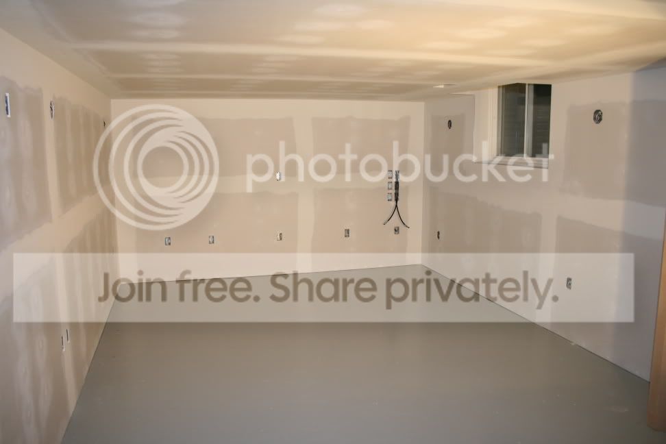

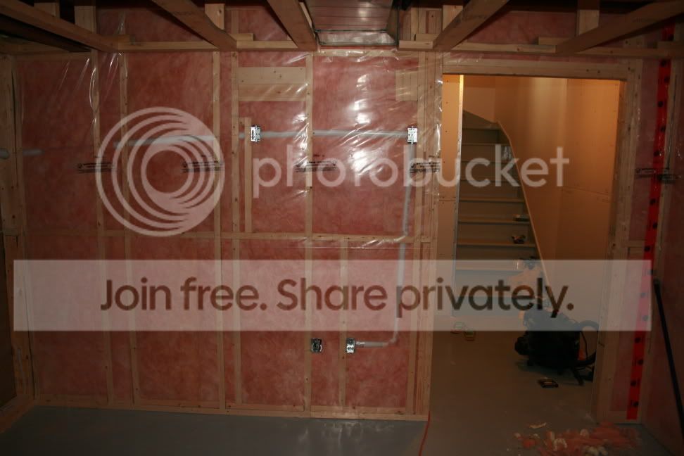

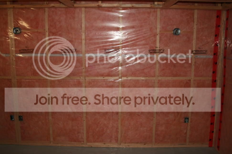

This is the left half of the right hand 19' wall. At the very top of the picture you can see the HVAC vent I plumbed in. Works well, keeps my room nice and cool, almost too cold some days!
This is right half of the right hand 19' wall. On the very end is the basement's only cold air return back to the furnace that I installed. I hope the 2" conduit doesn't restrict the return flow too much!

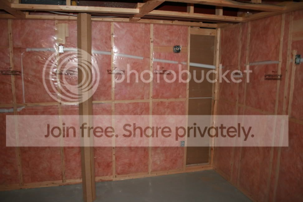

Here is the wall that has the entrance to the room. You can see through the door, that is the set of stairs that comes down into my basement. One mistake that I made here is that I planned for a 36" wide door, and framed in a 12" section of wall on the right side of the door. That whole wall is only about 11' 8" so it seriously impacted the placement of my two rear centers for my 7.2 setup... you guys said it won't be a huge deal. I hope not. You can see the conduit lead to two wiring boxes for the two rear centers. Not very much room to play with! The section of conduit heading straight down is for the rear sub.

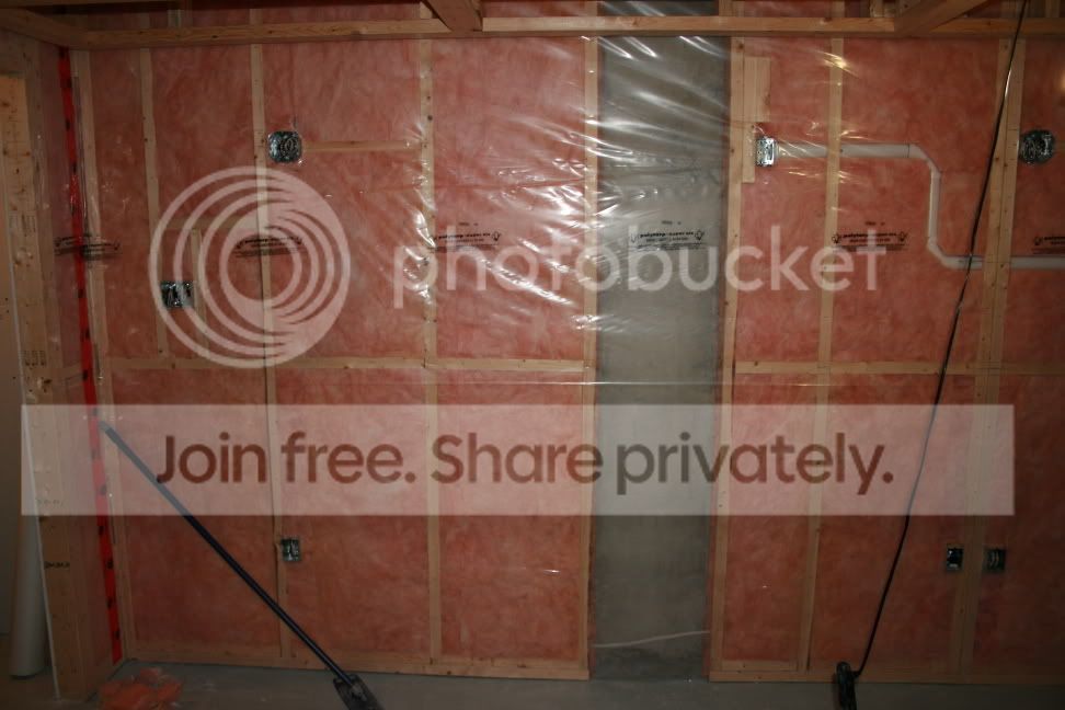

Here is the left side of the left hand 19' wall (this is the wall that is a shared foundation wall with my neighbor.) The entry door frame is slightly visible on the left edge of this picture. In the middle under the blocking is the conduit and wiring box for the left surround.
Here is the right half of the left hand 19' wall (the shared foundation wall.) Nothing too fancy to see here, but throughout the series of pictures you will see 6 octagonal wiring boxes, each of those are wired for a wall sconce... 3 sconces per each side wall. The double box to the right of the door frame in a previous picture will house 2 independent dimmer switches... dimmer 1 will control sconce 1 and 2 and 5 and 6. Dimmer 2 will control the two sconces (3 and 4) in the middle of each side wall.

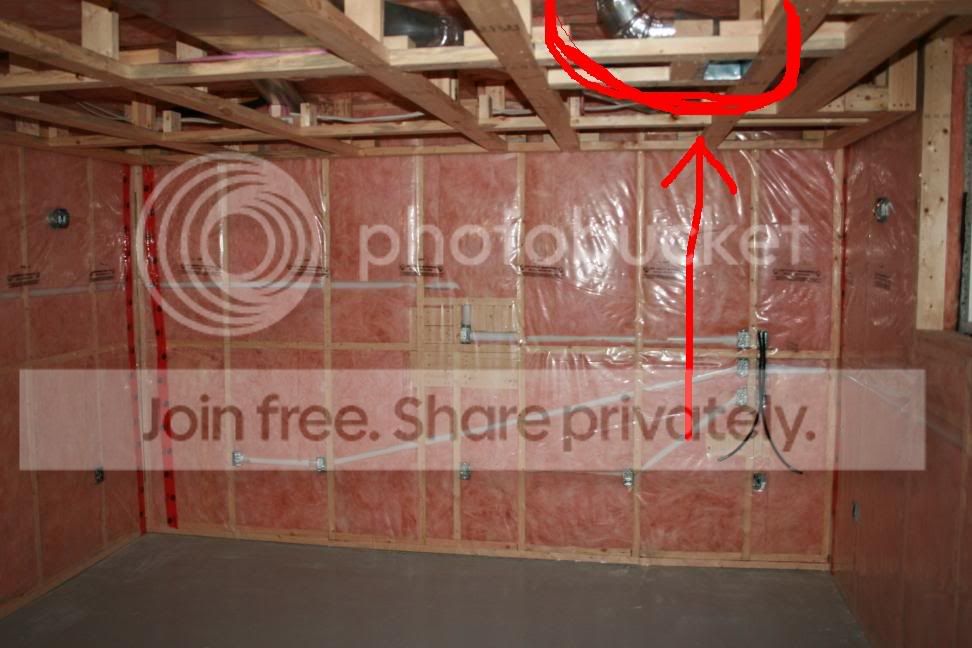

This is a close up picture of the input / output wiring boxes that feed the rest of the room and you can also see the zone 2 speaker wires I have already fished in to put music throughout the house. You can also see an unterminated drop of RG6 coax for the digital cable. The blocking you see is for a large power bar / surge protection unit. Below it is the 14/2 dedicated circuit to power the HT. My audio rack will sit directly in front of this and all the wires out of the back of the receiver will go straight into the wall behind it.
This is a closeup of the TV wall mount blocking and the in wall HDMI cable drop. Below it you can see the wiring box for the center channel.

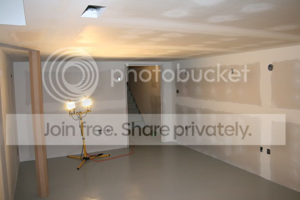

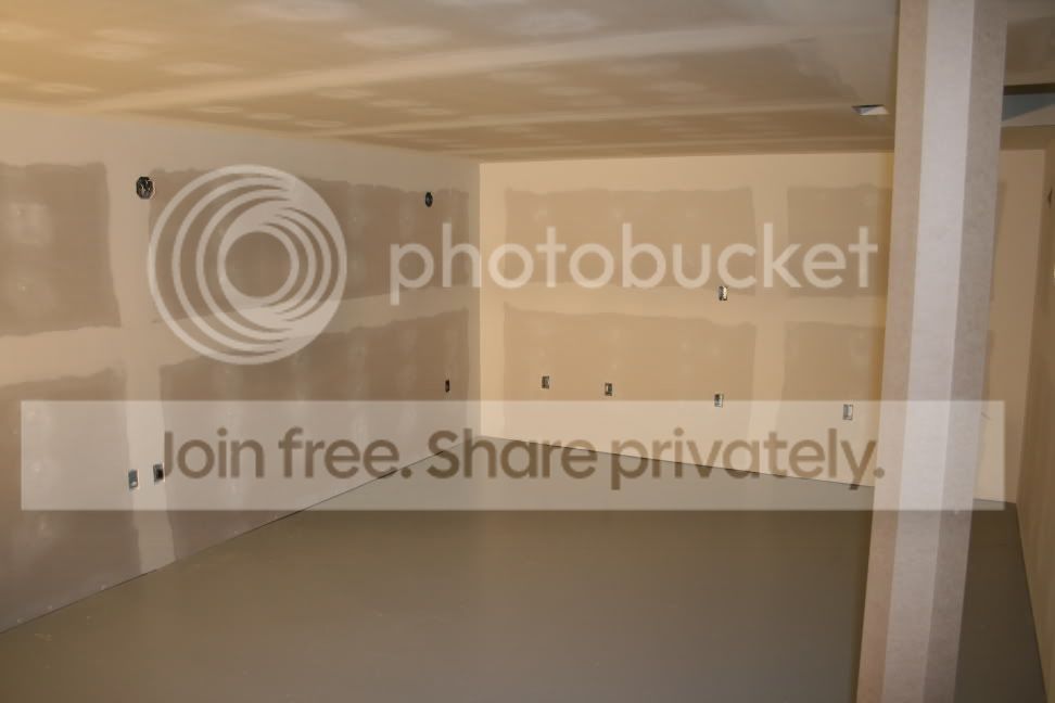

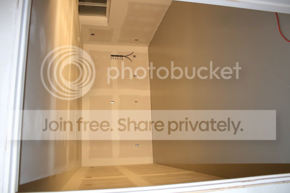

Shot from the doorway looking in...

- Full height ceiling. I have the feeling I will feel like I am in a cave after I am done. I really, really wish the previous owner of this house sprung for the bigger foundation.

- Choose a better location for the entry door. Unfortunately I really didn't have much of a choice in this house for the door because of the desired speaker layout and the laundry room conflicting with other possible doorways, but I really should have thought more before I started the rough framing.

Very nice work. You are doing it right. The only thing I would comment on, is surge protectors. HT done right is a big investment. UPS systems I think are cheap insurance and pay dividends. I have zero to minimal confidence surge protectors will give the required level of protection.
One other thing. I see you have partially blocked your egress window. That is a major code violation. Apart from not being a good idea, will give you problems if you decide to sell the house, as it will fail mechanical inspection. Hopefully you will never have to use this window, but if you do you will likely be cited by the fire Marshall, to add to the rest of your misery.

In regards to your second comment, perhaps I am misunderstanding your statement or maybe you can't see what I have done around that window... the pictures are admittedly not that great and don't really show what I did there.
I foresaw it being a problem if I did block that window whatsoever, so I actually framed a 2 foot "pocket" so to speak around it so in reality it's access is not impeded in any fashion. The pocket goes the full height right up to the ceiling joists, minus the thickness of a 2 x 4 for fastening surface for the drywall.
Would this still be against code? Would you mind elaborating on this, specifically why it would be against code? I am going to assume the main reason would be if you blocked that window and a fire started in the basement and you couldn't use the stairs you would need to use the window to get out safely?

I'm going to deal with the safety issue first, as I still have concerns. I did notice you had built the pocket round it, but could not see how big it was.
First off the purpose of an egress window is indeed to allow people to get out of the house if the exit through the stairway is blocked. It also allows the fire department to effect a rescue. As I retired critical care physician I can assure you they are vital.
Now did you replace that window? I ask this as I don't see how it works.
The window has to open easily. The one I put in in Grand Forks had two handles you pulled and the window came out.
When I bought the Benedict home, there was no egress window, in the back bedroom below ground. This is the grand children's bedroom. There are a stairs out and two outside doors. Only the back south wall is below ground, which is one wall of that bedroom. However I did not want a chance of any body getting trapped, so I had the window enlarged to regulation size. On this window there is a large handle to unlatch the window and then the whole window winds open screen and all.
It is a good idea to rehearse family evacuation plans, and having people open and get out of it in the dark is a good idea.
Now before going any further, I would recommend trying to get out of that window. You should not have to smash class and getting out should be quick and easy.
If you are in doubt, I suggest you contact your local fire marshall. They will advise and make recommendations at no charge.
It is hard to judge from the pictures, but that egress window does not look right, and at least from the pictures looks as if it might be a significant safety hazard.

I have thought about your room over night. I think you will regret the decision on the low ceiling. It will give a really closed in feel to the room. It is not good acoustically either. I don't think the fire marshal will like the ceiling lower than the egress window.
What is the other side of the wall opposite the egress window and is the ceiling open? Unfortunately your joists run the wrong way for an easy solution. If the ceiling is open you could run flexible heating hose between the joist to the next room, then duct or hose it to the Y and run another hose back between the joists to the T off.
That duct is for HVAC. Home vacuums have improved enormously. Personally, if there is no engineering fix for the duct, I would just take out the duct. I would swap the HVAC for a decent ceiling height any day.
The other option is to frame the duct, which I don't think would be overly difficult, but still spoil the room. I would have very little hesitation to remove the duct.
One other thing has occurred to me. I don't notice any air conditioner or heater ducts. May be I'm missing something? Even if you live in the Northern part of the country, and even though it is a basement, you will still need air conditioning. The equipment will give off significant heat and so will the people watching and listening to it. Without provision for air conditioning it will be like the Black Hole of Calcutta. Also you will need it to control humidity I have had basement spaces exclusively since doing the space here at Benedict. I can assure you even in ND and MN you need air conditioning in summer when there is equipment running.
Basement spaces are always a problem with mechanical ducts in the ceiling. I have to say I'm very glad not to have a basement space now. Even so calculating heat loads is important. I made sure there was continuous air extraction in the equipment room when the amps are fired up. I also put in a two big cooling vents. It keeps the space at satisfactorily cool operating temperature. Keep in mind cooling curves are log. So if the ambient temperature goes up the unit cooling goes down by the log of the increase. I've seen professionals who should know better make errors in this area. The operating temperature of electronic devices is one of the biggest factors determining failure rate and longevity. So it is important to get this right.

The pocket is pretty big, plenty of room... in my opinion, of course.
The window is a sliding window, it goes from left to right and vice versa. It has no issues opening or closing and I actually have lifted myself up and gone outside through it to my back patio through that window before, when I was putting the ceiling in... I didn't feel like going all through the house because I was all covered in sawdust and dirt, lol.
There would never be a need to break it's glass or anything.

From a safety aspect that window sounds fine. It just looks strange.
The answer to your question is yes, if the space is a living area.

I already do regret having the lowered ceiling, if it could be different I would gladly have it be different. I entertained many scenarios that would remove that duct run but since the joists run left to right across the foundation rather than front to back I can't tuck the ducting up into them... I also considered moving the duct to the left hand side of the ceiling so at least the framed box around it would be out of the way... but it would interfere with the entrance door and through consultation of a couple people experienced in ducting and heating, they said that eliminating that "Y" would impose on the balance and delivery of conditioned air to the main and upper floor of the house.
I also considered getting a wider but less deep duct to replace it with but I would have only gained a few inches at most.
What acoustic effects will a room with a lowered ceiling endure? I was rather curious about this, now you have me a little worried. Please elaborate.
I don't think you can see it from my pictures, but unfortunately that Y connects to two ducts that travel straight up the end wall feeding some vents on the main and second floor of the house, so it is not an option for me to eliminate it... if that duct run only fed the basement it would have been long removed from there. :(
If it were just a straight run all the way down I would have just framed and drywalled in that duct, but the Y fork is what kept me from doing that. I think it would look rather hideous after being drywalled.
There is a HVAC vent in my new room, it draws off the main trunk that runs straight down the middle of the room, I've highlighted it's presence in the picture below. Trust me, the basement is rather cool even in the summer without the central A/C on, with the central air on it is like a meat locker... seriously. I need to baffle it or something to reduce the flow.
By the way, I live farther north than that. I am from Canada. :D
Regarding your note on electronics and air handling in general, this is why I decided to plumb in a cold air return back to the furnace. I almost came close to saying screw it and not bothering with putting one in... when I bought the house there was not even one cold air return in the basement whatsoever.
Things run a lot more efficiently when you have a draw and supply, as I'm sure you're aware.
I suppose that is the cold air return. I thought from the pictures it looked a little small, so thought it had another purpose. Mine have always been much bigger than that.
I wonder if you could close the end of the duct at the Y and notch out the joists for a dual hose interconnect beyond that? I don't see a good picture of the Y. If just a few joists have to be notched, I don't think your house will fall down. If the distance is not great I don't think it will restrict air flow unduly either. Then you could box round it and it would just look like a beam.
Can you post a photograph from the Y on?

The picture that I drew the red arrow on is pointing to a supply duct.
The cold air return was shown in this picture:
I don't know how cold air returns are done in your neck on the woods, but here they are typically plumbed in using a drywall chaser. You can't see it in the pic but there is a section of return duct that terminates at the top of that open section of stud. After the drywall goes on the face, a 16" by 8" hole with be cut out of the drywall between those two studs, typically near the bottom, a few inches off the floor.
Attach your grill over that hole and you're good to go.

I neglected to mention earlier, but if you look closely in the picture I linked above, you can see an 8" I beam that hangs down below the joisting, just as the main duct trunk does as well. You can see the support post in the octagonal cover at the left end of the I beam. The I beam hangs just as low as the duct line and it is most definitely not movable as it is obviously load bearing... so removing the duct line not not truly alleviate the problem, unfortunately.

Update!
As of October 15th 2008 here is where I am at with my dedicated home theater room... it is starting to come along nicely now. I can't wait!!
As always, I welcome any feedback or comments. Stay tuned, more pictures to come soon!

Wow, that has really come along quite a bit!
*busts out crystal ball, and wraps funny turban around head*
Yeeaasss, I see in your future.... a projector, acoustically transparent screen, false wall, all black room....
edit: its been too long, sorry. This is sort of a temporary residence? Oh I can't remember, but you mighta said that. Oops! :eek:

Thanks Josten!
It is not really a temporary residence, I'm probably going to live here for another 5 to 7 years, give or take. I'd definitely not be doing all this work for a place I won't be living in for the foreseeable future. Way too much work! lol
As for all that stuff you listed, that will be in my next room. ;)
