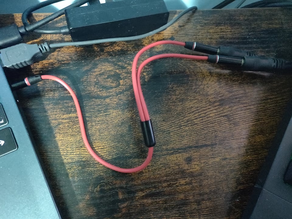

First of all, I have just a regular amp that came with 2 big speakers and from there, there is 1 output to aux. But its high pitch speakers blew So I connected two smaller ones and from there, there are 2 aux outputs that I have made to 1 with a simple cable merger (I know it lowers quality). So the first question is what is the correct way to do this.

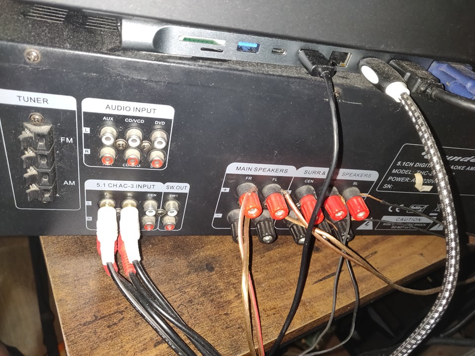

This is how it is setup now Total 4 speakers with the 2 main big ones and 2 small ones
From what I understand from you, guys I can hook up a sub, but it has to have its own amp?
Also, I meant the connection to the laptop is like that(pic) but If I add center they become 3 so it's really poor quality then at high volume. So I need some external merger or smth?

Okay, I misunderstood you. I was picturing additional speakers spliced together on one channel.
Yes you can add a subwoofer but it will need its own amp. A lot of subs come with the amp already built in, but you can find them without and use a separate amp to power them.

As far as using all of your speakers, are you using the left/right rca outputs on your laptop with splitters going to the surround channels?

About "left/right rca" I didn't quite get that there is only one aux output on the laptop I think they are all like that and into the splitter goes the cables from 5.1 CH AC- Input. I think they are also basic they go 2 to 1aux each. From what I understand tho this is not a good way to send a signal from the laptop to the amp.
And now if I add a sub and then a center they would become 4 aux that would need a signal.

Looks like you've got some older gear. The 5.1 ch AC-3 inputs you're using are most likely meant for a DVD player. I'd plug the laptop into one of the 3 audio inputs above what you're using and not split the signal any further than that.
You would connect a powered subwoofer to the ports that say SW out, which are right next to the 5.1 channel inputs you're currently using.
This looks like a pre-HDMI receiver, if you want multi-channel music from your laptop I'd recommend updating your receiver to something with a few HDMI inputs.

Yeah its very old I got it like 8 years ago. But it still works great! So from what you said those ports are for surround sound? And the above aux is just for stereo? I'm not looking to make home theater or something this is just for music and maybe I will plug a DJ board because I want to mess around a bit. I am going to try with just one cable in the above port later.

Yes, the aux above are for stereo sources. The inputs you're using are meant to be used with DVD players that have their own analog outputs for surround sound. You may have some different sound modes in the receiver that will allow you to use all 4 speakers with a stereo source.
