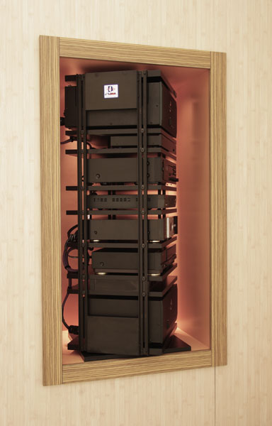

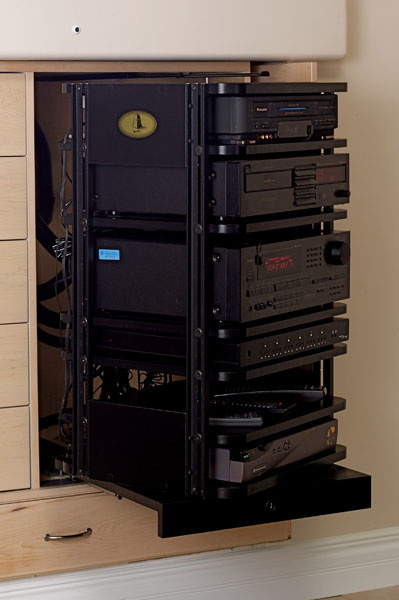

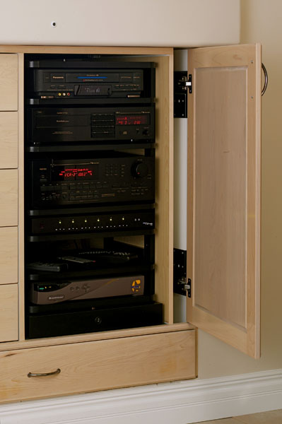

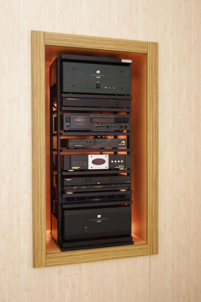

For the cabinet design I was looking at these Cabinets available in Canada.

The rack you are showing is kind of small for this as you would typically dedicate a few sources to the system right away and you MUST have good cooling for the amplification.

If the home is new construction I would avoid the pretty rack, and try to put a space in your home with good ventilation where all the gear can be hidden or accessed from behind. Rolling racks can be troublesome in the long run if not done properly, and you want to ensure that you have enough room to grow the system as your needs require.
