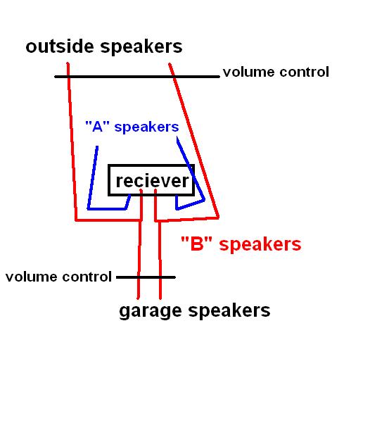

We are building a home and I would like to do some in-wall speaker wiring. I’ve done the basics before, now I just want to step up to having a “B” set of speakers to control for outside. So here are my questions:
1) Can I have my “B” set of speakers be 2 speakers outside on the back porch and a set of 2 speakers in the garage? Can wires for both sets of speaker wires go off the same wall panels (L & R) behind the receiver to different wall panels outside and in garage?
2) To control these “B” sets of speakers outside and in the garage I’d like to put in separate volume controls, but I’m not sure what exactly to get. I’ve seen lots of the dimmer (round knob) types, but am not sure of the tech specs I would need (and these go between the receiver and the speakers somewhere along the speaker wiring route?)
2b) Can I use on of the regular volume/dimmer controls outside the house? (Under covered porch, but here near Toronto, so we get snow and below freezing to humid and in the 90’s each year…
3) Is there a good/better/best type of plug to use for the speakers? I just used regular wire-pinch style clips in the wall of my last place; are banana plugs or other style plugs better for attaching the speaker wire to the plates on the walls? (Especially for the outside speakers – they will be under the roof of a covered porch.)

For your multiroom speakers, you should first consider that most receivers are designed to run the A OR B speakers and not A AND B. If you have multiple speakers connected to the B speaker terminals, then you will want to use impedence matching volume controls. These will allow your receiver to see an 8 ohm load (instead of 4 ohms) when two pairs of 8 ohm speakers are connected. The link below is a good price on a high quality volume control with the impedence matching feature.
http://www.amazon.com/gp/product/B0001EMLRK/qid=1138291768/sr=8-1/ref=sr_8_xs_ap_i1_xgl23/102-1055522-2164167?n=507846&s=electronics&v=glance
For the outdoor VC, you will need a weatherproof enclosure with cover, or an outdoor version of the VC. You might consider placing it inside by the door to the patio. For inwall and outdoor wiring, make sure you use speaker wire with an outer sheath that is CL rated. I would run the speaker wires directly from the VC to the outdoor speakers to eliminate exposed connections which would corrode.

Thanks - very helpful info. I'm rethinking and I'll probably just put the VC inside the patio door, still handy, no weather issues.
I have got the in-wall approved speaker wire, and I'll make sure not to run A & B at the same time (can't forsee that coming up much anyway).

Niles or Russsound make speaker selector switch..both with and without volume controls..
I use I use a unit that handles 6 pair of speakers, with individual volume controls for each pair .. runs less than $200 on ebay
Russsound makes a unit with 2 inputs.. so you have a choice of what's coming out of each pair of speakers..
