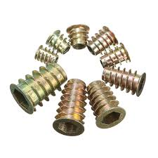

I prefer to use threaded inserts made for softwood (not hardwood). They come in a variety of lengths and diameters. They also come with flanges (as shown below) or without them. In my hands, these threaded inserts work much better than T-bolts or hurricane nuts. For a large woofer, I'd use ¼" diameter threaded bolts, but less than ¼" can work.

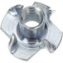

This is a T-nut (below). They can work alright in soft wood like fir, pine or some plywood. With MDF, I avoid them like the plague. Getting the sharp prongs to actually penetrate all the way into MDF is difficult enough to make the effort fail.

This is a T-nut. They can work alright in soft wood like fir, pine or some plywood. With MDF, I avoid them like the plague. Getting the sharp prongs to actually penetrate all the way into MDF is difficult enough to make the effort fail.

For what its worth, threaded inserts also require that you drill starting holes for them. But I find them easier to work with than T-nuts. Maybe it was my failed experience with T-nuts that made me drill more carefully when I used threaded inserts. I also practiced in scrap wood before I did it on the speaker cabinets.
One brand of threaded inserts is E-Z Lok. Buy the inserts meant for softwood, not the ones for hardwood.
In my hands, I drill a full length starter hole while carefully holding a hand-held drill as perpendicular as possible. Unlike for T-nuts, these holes don't have to be full diameter, just wide enough to allow the insert's outer teeth to get hold. Next, you drive the insert in by hand, with an Allen wrench. The outer teeth of the inserts are tapered. As you drive it in, it tends to go in perpendicular. I found this worked well with large drivers that had multiple bolt/screw holes, much better than with T-nuts.

T nuts suck unless they can be held in place with a screw. Threaded inserts are the way to go but they need to be set deep enough to avoid pulling through.

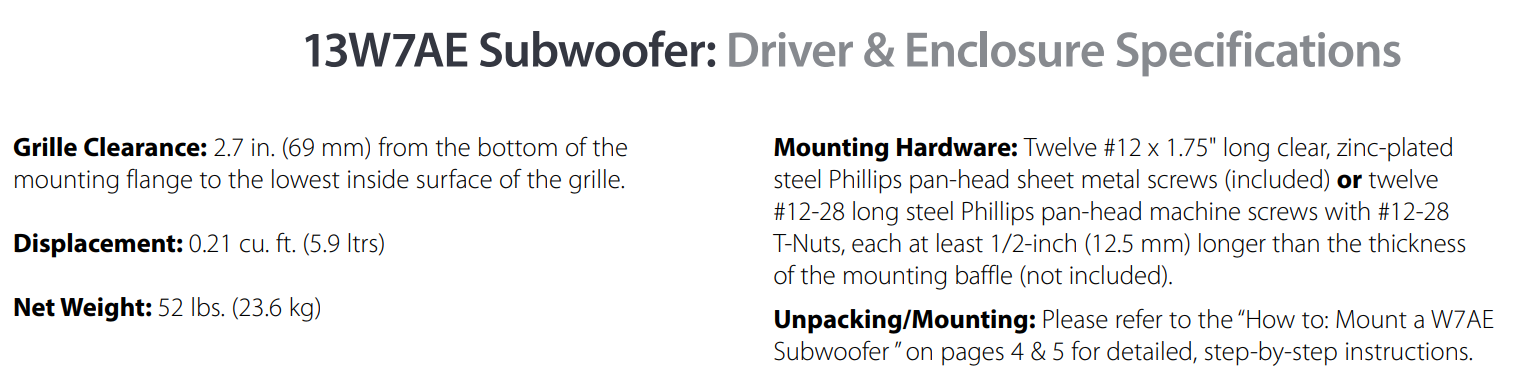

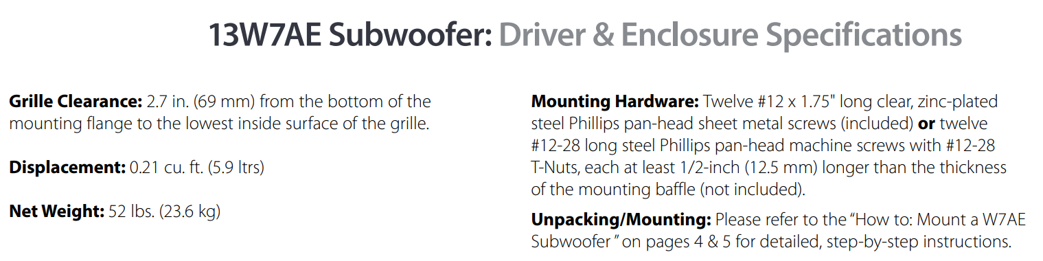

fwiw, JLs W7 subs come with pan head sheet metal screws...
That's useful info, except for one thing. The pan head screws JL supplies are good with one major exception … they're Phillips head. For that reason alone, I would throw them out and replace them with similar screws where the heads are either Square Drive, Hybrid Square/Phillips, Allen Head, or Star Drive. They're widely available, in stores or online.
Throw out those T-nuts too. Use threaded inserts (see post #5 above). You'll thank me later ;).
