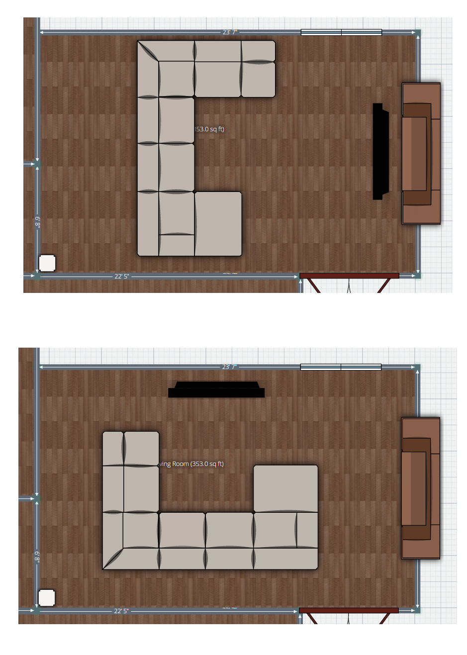

So I've got a brick fireplace and looking to mount tv and run cables.

That looks like a good spot for a projector screen to me. :) If you want to avoid running power and signal wires against that brick, then a projector would be one way to do that.
Re: HDMI cables, just use a Redmere cable. They're thinner than Cat 5.
I'm lost on why you'd need multiple HDMI cables going to your display. Why do you need more than one? DVR, Blu-Ray, game console, PC, and other gadgets all plug into your AVR. AVR plugs into the TV. That's it, just a single cable. Right? You weren't planning to use your TV's built-in speakers were you?

I agree with TLS Guy, placement of the tv where former owners setup was nice and with that being said, with your tv being place there provides you with more setup options but of course peace will only reside in the camp if the wife is:)...LOL
Another vote for not over the fireplace placement....

Good question...We've got a big as truck couch and it seems to fit the room better when facing the fireplace.
The wife's seen HGtV shows where it talks about having the long part of the couch perpendicular to the long dimension of the room, and also to not have competing focal points in the room....the TV wall vs the fireplace wall.
all this gung sheui stuff, i dunno. I agree, it would be much easier if it was mounted on the wall. Attached are some wide angle pics to see.

Seen a lot of audiophile shows on HGTV then, have you? Lots of discussion by the Property Brothers about acoustics and proper placement and distribution of speakers?
Over the fireplace = very bad.

Damn great looking place, congrats and enjoy. Maybe in my next life. I agree no fireplace.

wife took more pics today...big decision. It certainly would be a hell of a lot easier and less work to mount on the wall...but I feel like the room is more open w/ it facing the fireplace.

You don't anticipate the mounting height of the television over the fireplace giving you a crick in your neck? Were you planning on floorstanding speakers or bookshelfs? If bookshelf speakers, would you use stands or put them into the built-ins?
