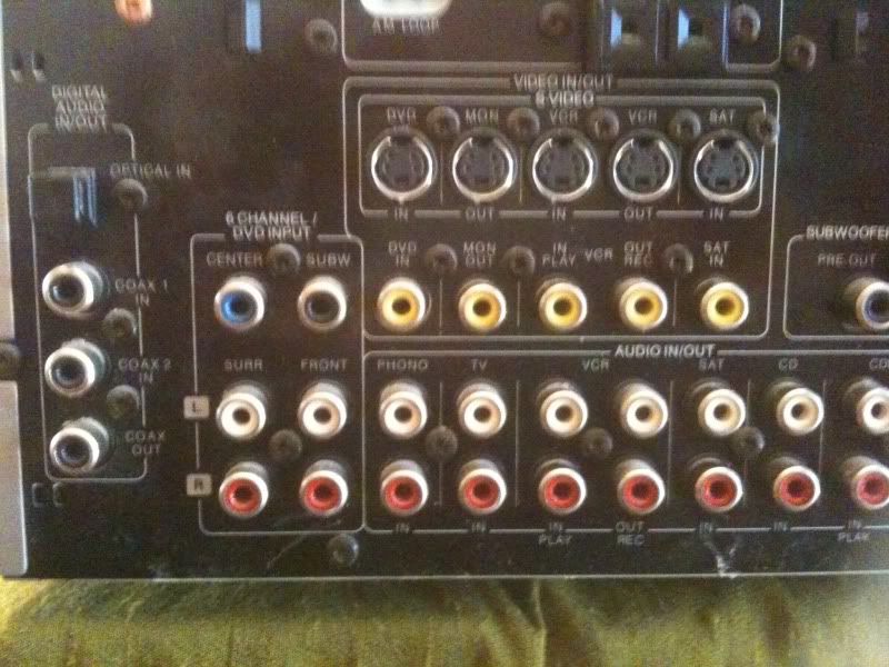

Here is a picture of my receiver:

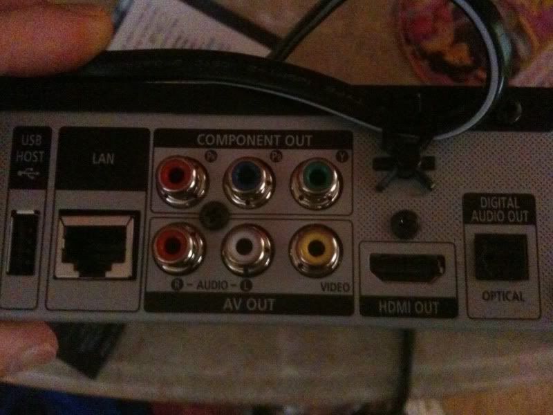

and here is a picture of my BluRay Player:

Based on the connections on the back of the blu-ray player, you'll want to use the optical digital audio output and connect that to your receiver.
Jerry mentioned using multi-channel analog connections if you have them (that would connect to the "6 CHANNEL / DVD INPUT" jacks on the back of the receiver), but your blu-ray player doesn't have those (neither does mine). So, go with the optical connection. It will sound immensely better than the red/white analog connections.
Which blu-ray player do you have? I could look up if you need to set anything in the set-up menu to get the best sound from that optical connection.

There are no other orange type RCA inputs on that unit...?
There are two coax digital audio inputs. They just aren't orange - the receiver pre-dates that color coding. :)
