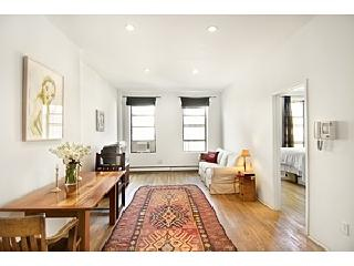

Here is a picture of the main listening/viewing area. This exaggerates the size (it is the realtor's photo, go figure :p ) It shows future location of my equipment and sofa (the actual items in the photo are long gone). the window wall is about 12' wide and 10' high. the floor is wood, the walls are painted, and we'll probably be using cloth curtains on the windows. the part of the room behind the camera is another 10 feet or so to the wall (so it is around 26 feet total from the windows to the wall parallel to the windows), and the room bends a corner in an "L" shape to become the kitchen on the right-hand side. Sorry if this is too much unnecessary information. . .
Thanks again for any help.

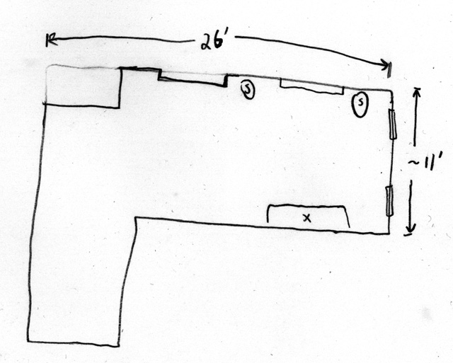

here is a rough drawing that might be more useful in conveying the room arrangement. X is the sofa, (S) is the approximate speaker location.
