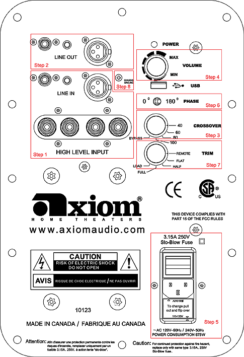

Mike, can you post pictures of this fusebox deely. It sounds interesting. :)

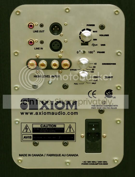

sheep, look at the area below the plug.
I noticed the 120 / 240 thingy but did not notice the little black box just the size of the plug port with tiny embossed words that was supposed to be pulled out and then flipped over.
check out the picture in RMK's link
its much much clearer in the manual, though as you can see in the "real" picture, there were much more words written on it than "to change pull out and flip over"
