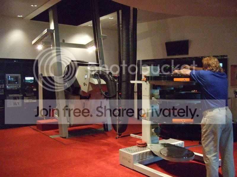

1) The MF-10 is based on the RS-100, a professional series Japanese model, not the RS-2. The RS-2 is a consumer based version of it. So you were WRONG here.
2) Meridian wipes the OEM lookup tables for video reproduction and completely re-programs the projector to Faroudja video calibration specifications. Not even ISF Calibration Services or JVC AMERICA have the ability to unlock the potential of this projector as Meridian/Faroudja. Did you report this? NO.
3) Meridian has an exclusive contract with JVC JAPAN to grade projectors and send back the ones that don't meet Meridian's hardware performance minimums, which equates to about 3 out of 5 JVC RS-100s returned to JVC. Were you aware of this? NO.
4) Meridian also break in the bulb in the orientation in which the projector will be mounted, which they claim is critical. Does JVC do this? Did you report this? NO to both.
