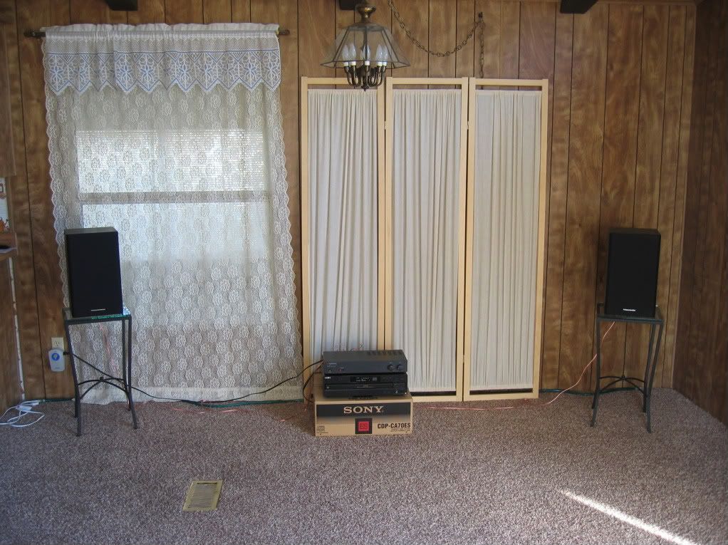

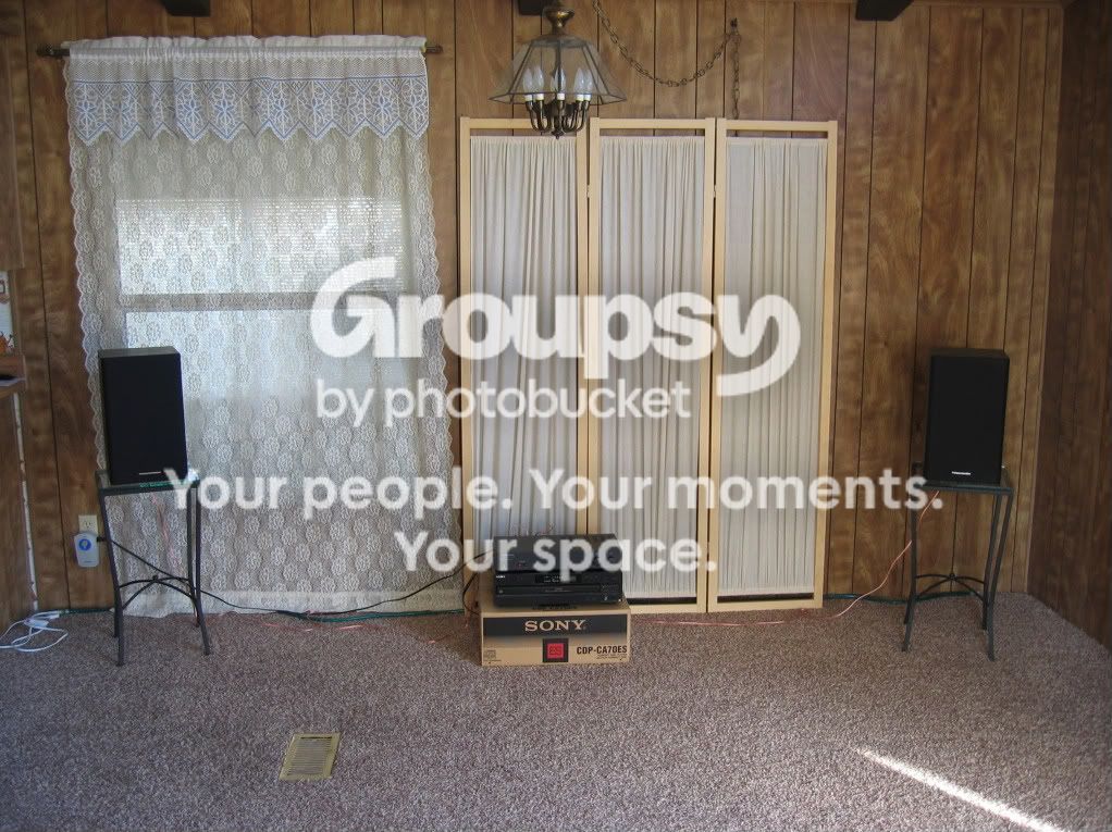

That ain't a knife, THERE'S a KNIFE....I mean how about THIS as less than ideal :) Been a while since I had this setup. Was like the first week in the house.

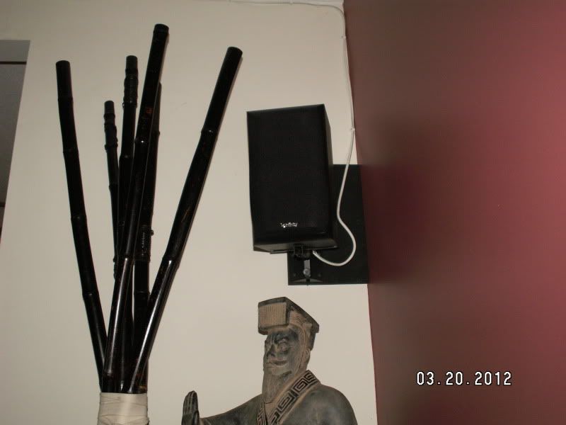

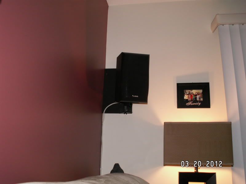

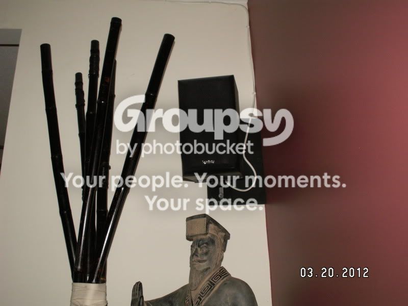

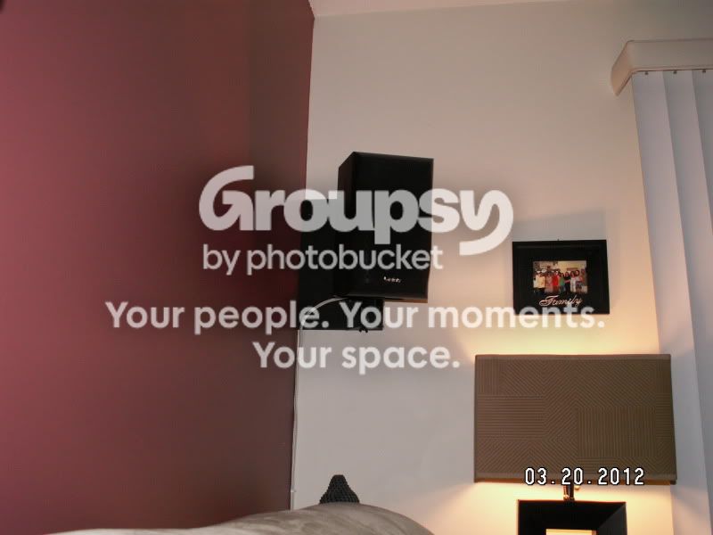

Speaking of less than than ideal situations here's my surrounds from the primary listening position.
Left
Right
According to one set of rules they are about right, a couple of feet above the listening position and pointed slightly
ahead of it which is fine except that they're jammed into the corners and of course according to another set of rules
for MCM they would be way closer to the same height as the listener. It's like when you figure you got all the answers,
they change the questions.
