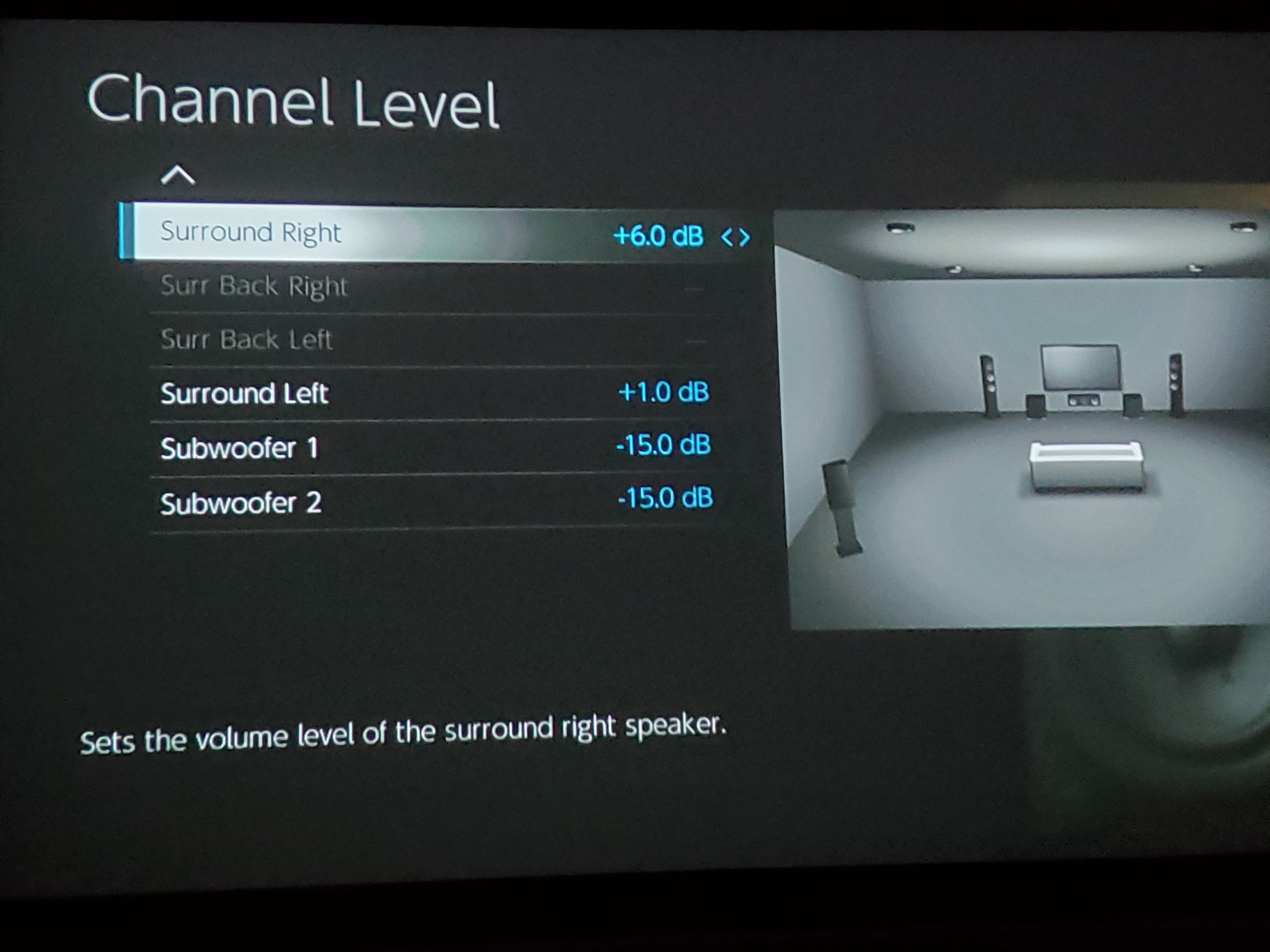

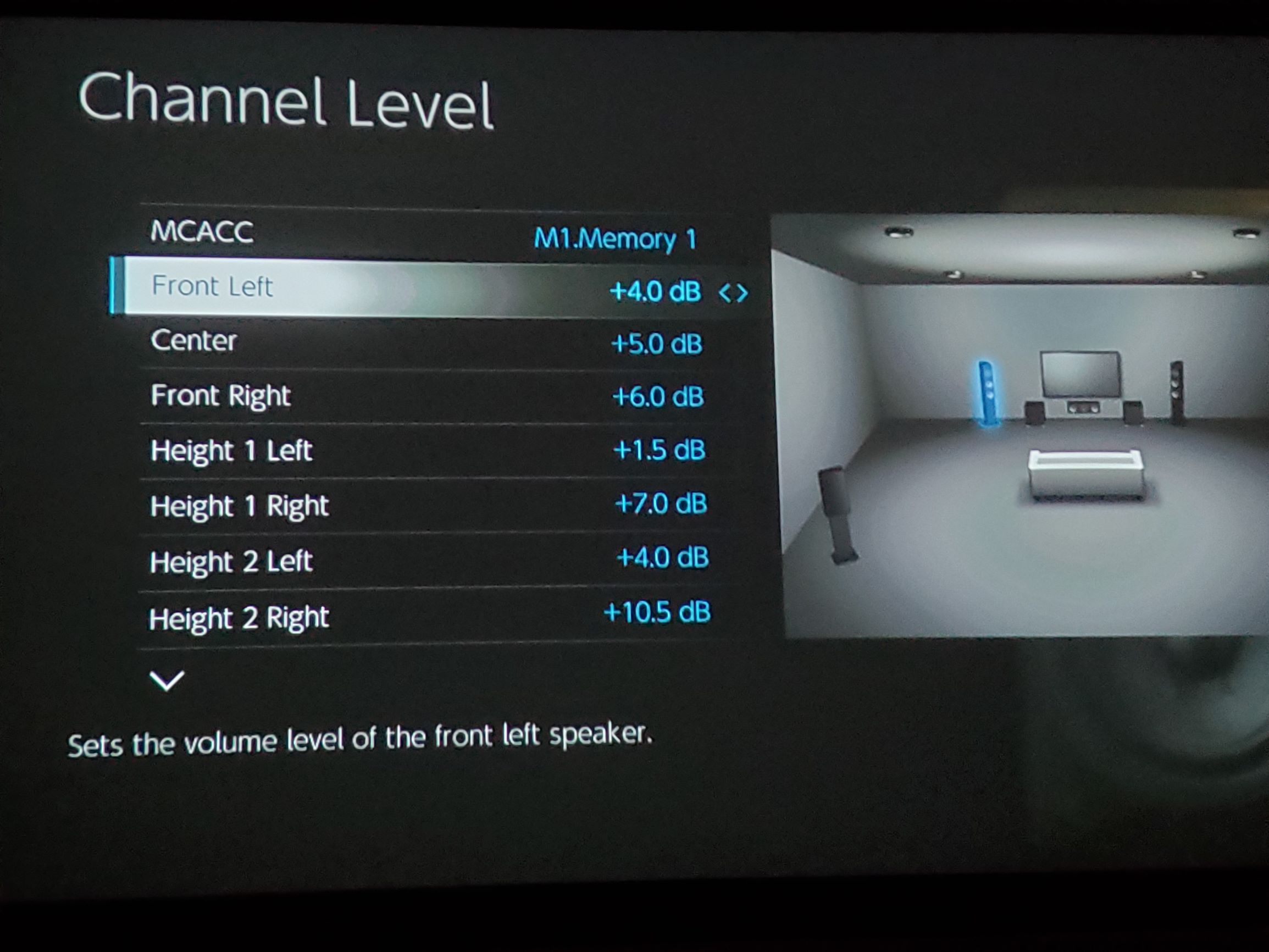

What settings do I need to adjust in the menu to account for the Carver taking over the surround channels? I will read the manual, but i'd love some advice/tips/secrets of the pros.
ryanosaur
ryanosaur
just run you room correction. let it select your levels and distances. if you don't want room correction on after that, turn it off.
