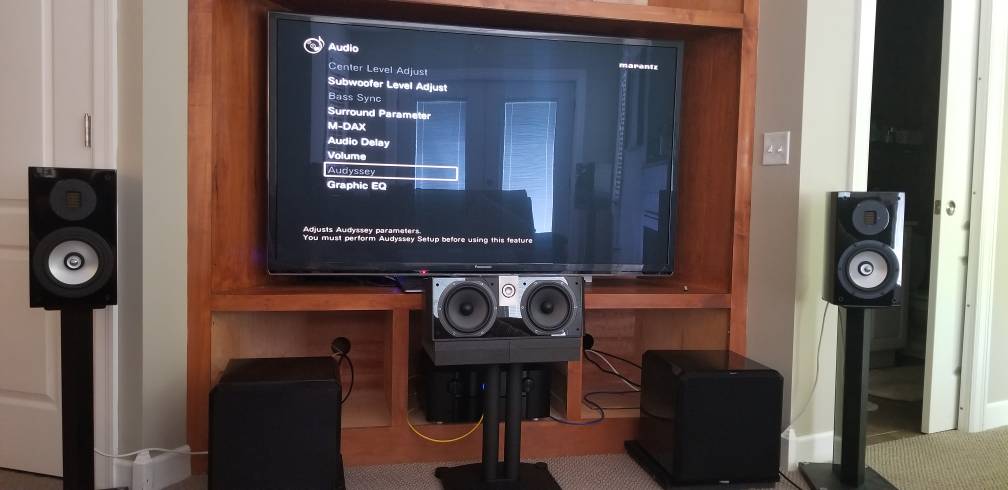

In fact the system doesn't recognize that it was even performed. The distance, xover, etc data is there but in the setup -> audio tab Audyssey is greyed out asking for a calibration to be completed.

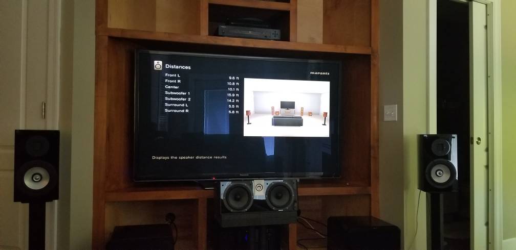

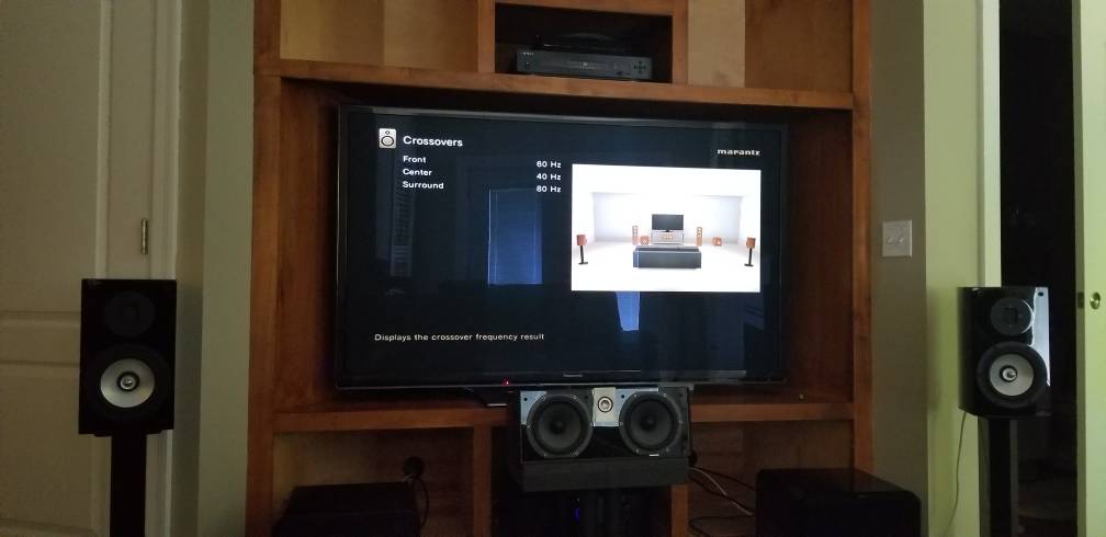

I've added some pics of the screens mentioned for reference.
