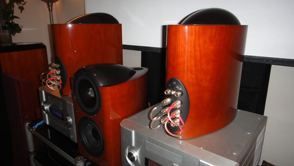

Since I joined I have seen numerous threads regarding Bi-Amping. Still being a Newbie, what is it about Bi-Amping that makes everyone think this is the best way to go?
GranteedEV
GranteedEV
No one thinks it(bi-amping commercial speakers passively)'s the best way to go, except people who don't know what it is.
The problem is that the esoteric community "wants to see" all sorts of useless things.
What you end up with is speakers with a bunch of connectors at the back
And people wonder what they're there for. (Nothing being the correct answer). And so they google what they're for.
And then they find misinformation about bi-amping bringing people's speakers to life :rolleyes:
And then we have to break it to them that they're wasting their time.

Those speakers look darn familiar...............haha :D
