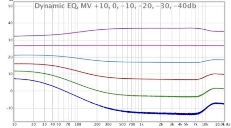

The other Audyssey feature we have not talked about is Audyssey Dynamic EQ. This feature allows your system to have the same bass punch even with low volumes and it works automatically while providing the user with custom settings for the amount of Dynamic EQ applied. This can make a nice difference in the depth of the music. Most users love this feature.

I always like to share this graph when dynamicEq comes up. You can see the relation has with the high, and low end and how the MV affects the whole curve. Most people don’t associate Deq with treble, but it’s there.
Which setting do you use?
I’ve been using either LR bypass, or limiting to 200-300 with the app. I usually listen at about -20 or so and use a minidsp/rew to build my own house curve. Plus I hate what Deq does to my surrounds, and rear tops. Makes em too hot... I do like what Deq does for bass at lower volumes and I know @lovinthehd likes the RLO’s but I still haven’t used them successfully much. It’s almost winter now though, so I tend to experiment more.
Well I do use the RLO setting to differentiate between use for movies vs music, particularly upmixed music. If surrounds are hot, trim 'em down :)
I could trim, but the Deq level changes via MV level so I’d have to know how much. Too much fukkin around lol. The house curve is where I like, and I listen loud enough so the Deq is subtle anyway. If I’m listening more quietly, it’s probably not something with great bass anyway lol.
I've adjusted surround levels for Audyssey surround levels before in some circumstances, find that just taking a few dB off trim level can work well at various levels via DEQ....
I’m normally a set it and forget it. But, I’ve been itching for a new sub calibration, and once over for the system. You know, to make sure I’m getting the most out of for all my winter viewing. Which is when I get to use my system more consistently. I will definitely let you know when I get to experiment with things. One problem is my laptop is fukked atm so... rew and minidsp are where they are. For now.

Yes, Audyssey Dynamic EQ is essentially a loudness contour, altho more comprehensive, for adjusting things below reference level.
