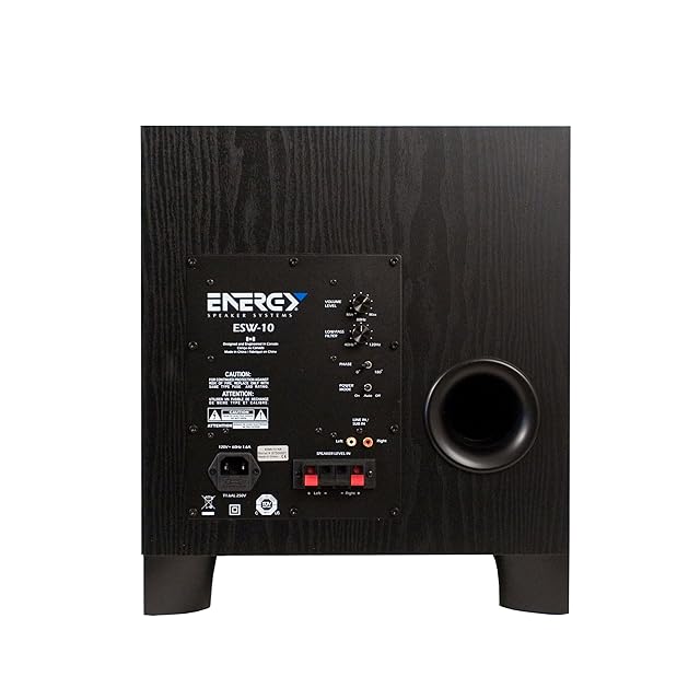

I am in the same position and hope that someone will help me out. I have a new Maranat 6004 receiver and need to hook up a sub. My sub is an Energy ESW-10. It has a low pass filter control, a phase control switch and a left/right line in/sub in connection.
can some please reply and let me know how to connect this?

Hi, John. The images that I saw on the internet for the ESW-10 (e.g. from Amazon.com shown below) show that it has speaker-level inputs. Does your version have those (I ask because Amazon might be showing the wrong image, such as the ESW-C10)? If so, you could connect it to the Marantz that way assuming that you currently only have one pair of speakers hooked up to the Marantz. Blending it together with your speakers is a bit more involved because your amp won't be handling the bass management, but it is possible to do. What speakers are you using?
