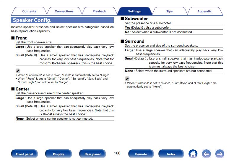

You should be able to disable speakers using the receiver's internal manual speaker setup menu.
You don't have to physically unplug speakers to silence them. Disabling them in the menu should cause the receiver to down-mix the rear surround channels to the front speakers. Simply unplugging the surround speakers would cause the rear-surround audio to be lost entirely, since the receiver wouldn't know they're missing.
Disabling the speakers shouldn't disable Audyssey, either. That should only happen if you later add more speakers than you have now.
