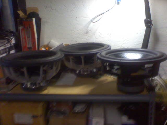

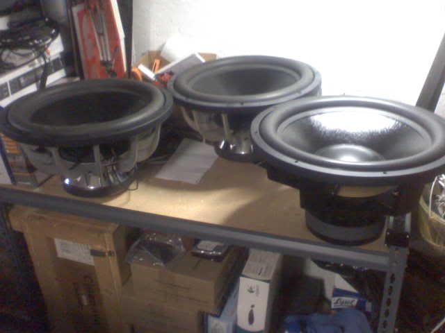

I'm gonna do a mix batch of Maelstrom X18 and Avalanche 18"s...here are the lonely 3 drivers left:

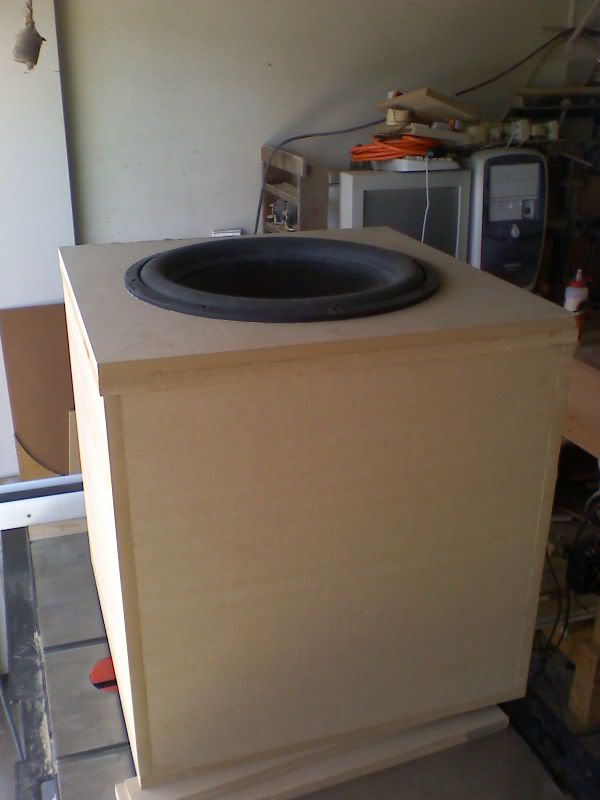

here is one of the completed ones:

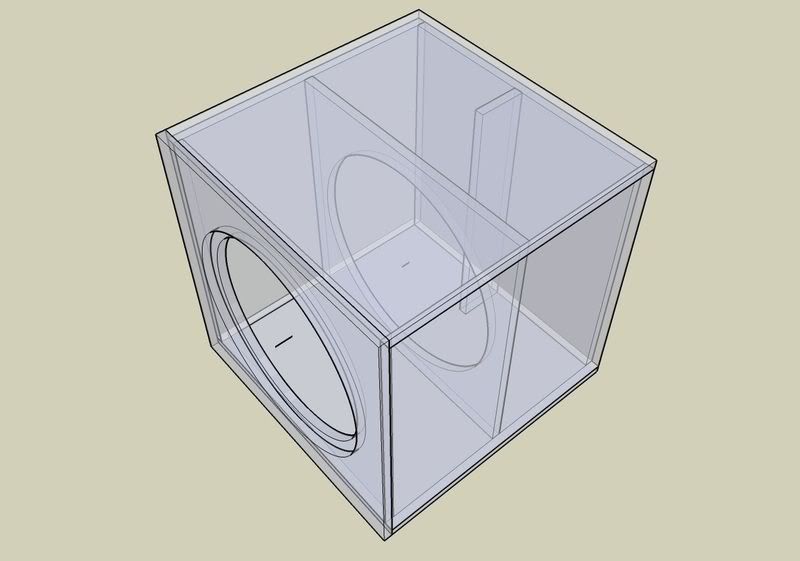

plans (bracing is incorrect in this pic..there is much more bracing):

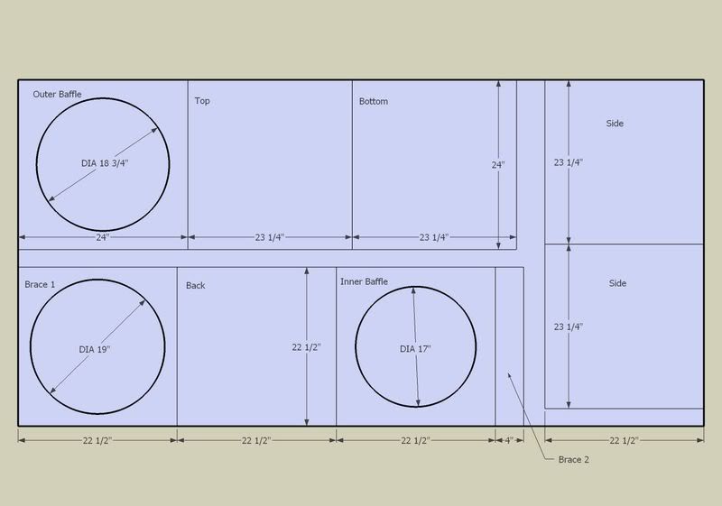

cutout:
