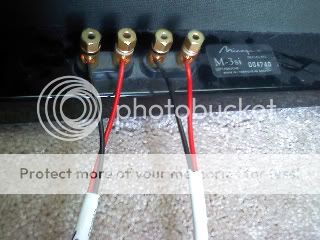

This is about my latest revision in how I am driving my M3SIs. Also, to all the people who have said "why are you biamping?" (while leaving the speakers x-overs in tact) in all the discussions about biamping, "I give".
I am using a Citation 5.1 amp to run my M3SIs. It is a 4/3/2 chan amp, dual mono design, 4x100 or 2x300 @ 8 ohms. I had been running it in 4 channel mode, 2 channels to each speaker.
I was doing this partially because I have another nice 2 chan amp (BIAMP Systems-Eminance 300) that I wanted to switch the mids/tweets over to on occasion. They had slightly different characteristics (imaging/detail etc) and I thought the change wold be nice. I also thought it was the better way to hook it to my spks. I never really gave the bridged mode of my Citation much of a try.
Well I did give it a try, it turns out the increase in power output made a much bigger difference than any possible/perceived advantage of "biamping" (the way I was doing it anyway). The M3SIs are notoriously power hungry (83db @ 1watt/1meter) and many reviewers have said they need 200+ wpc to really come to life, man is that true. The spks are 6 ohm (4 ohm min) so I am probably getting ~400 wpc from the Citation in bridged mode, which has really opened them up. I have a definite improvement in dynamics and bass, two areas I had always thought weren't quite what they should be. I love the fact that I was able to make my spks sound even better, I already loved them.
I have started using my Eminence 300 to run my center channel, instead of the built in amp in my Yamaha rec. That made a big improvement in my home theater sound as well.

I am aware of that, it has no problem running bridged at 6 ohms, barely even gets warm. I have seen posts about the Citation 5.1/7.1 running 4 ohm loads bridged without any problems, only getting a little warm (actually the 7.1 didn't even get warm). I believe it is stable at 2 ohms / 4 ohms bridged.
I just Googled and found this article of an interview with "Stephen Mantz" the designer of the amps. According to him they are stable to 1 ohm / 2 ohms bridged, producing 1Kw per bridged chan @ 2ohms. Man I love these amps.
