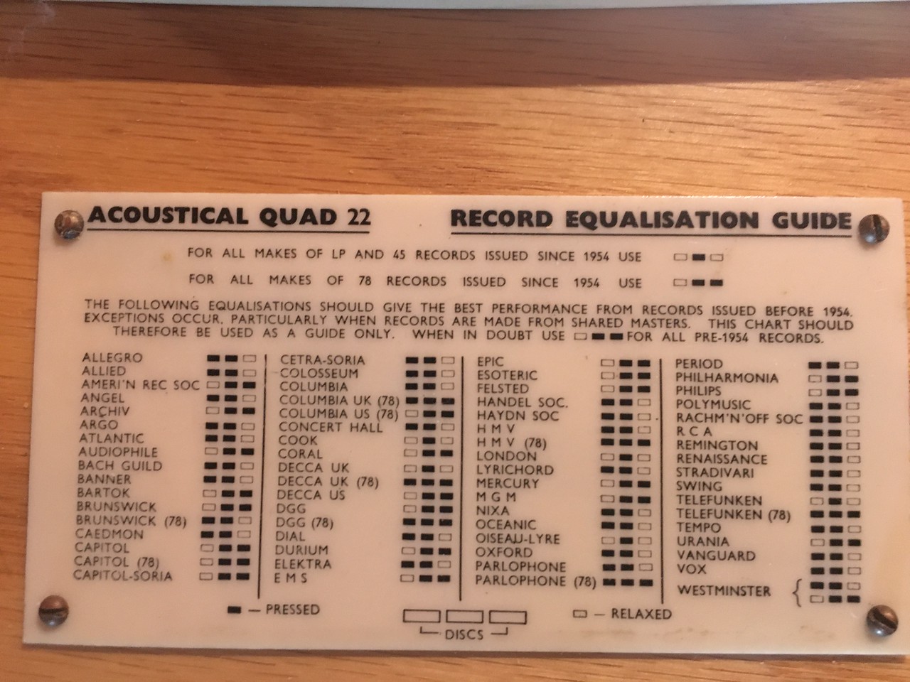

If you are going to play 78 shellac discs then you need a preamp with the correct equalization codes, which is different among labels.
They did not agree on an equalization standard for 78 RPM records until 1954, right at the end o the 78 RPM era. Thank goodness at the outset the RIAA curve was set for LPs!
Another issue, that can be a problem is the the stylus radius was not settled either. So the extreme 78 enthusiasts have cartridges of various radii. The speed was not completely settled either, and that is why back then some speed control was usually added.
That also meant that back in those days, a lot of cartridges slipped on and off to be able to change them instantly. That is why the Decca ffss was designed that way. So you could not only change quickly form 78 to LP, but if you were an obsessional collector you could have cartridges with a range of stylus radii.
LP Head.
The preamp is a Quad 22 tube preamp I bought in 1966.

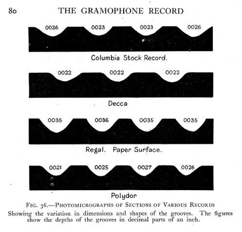

Here is data on some 78 RPM groove sizes. You can see one outlier there, but most of the majors were close.
