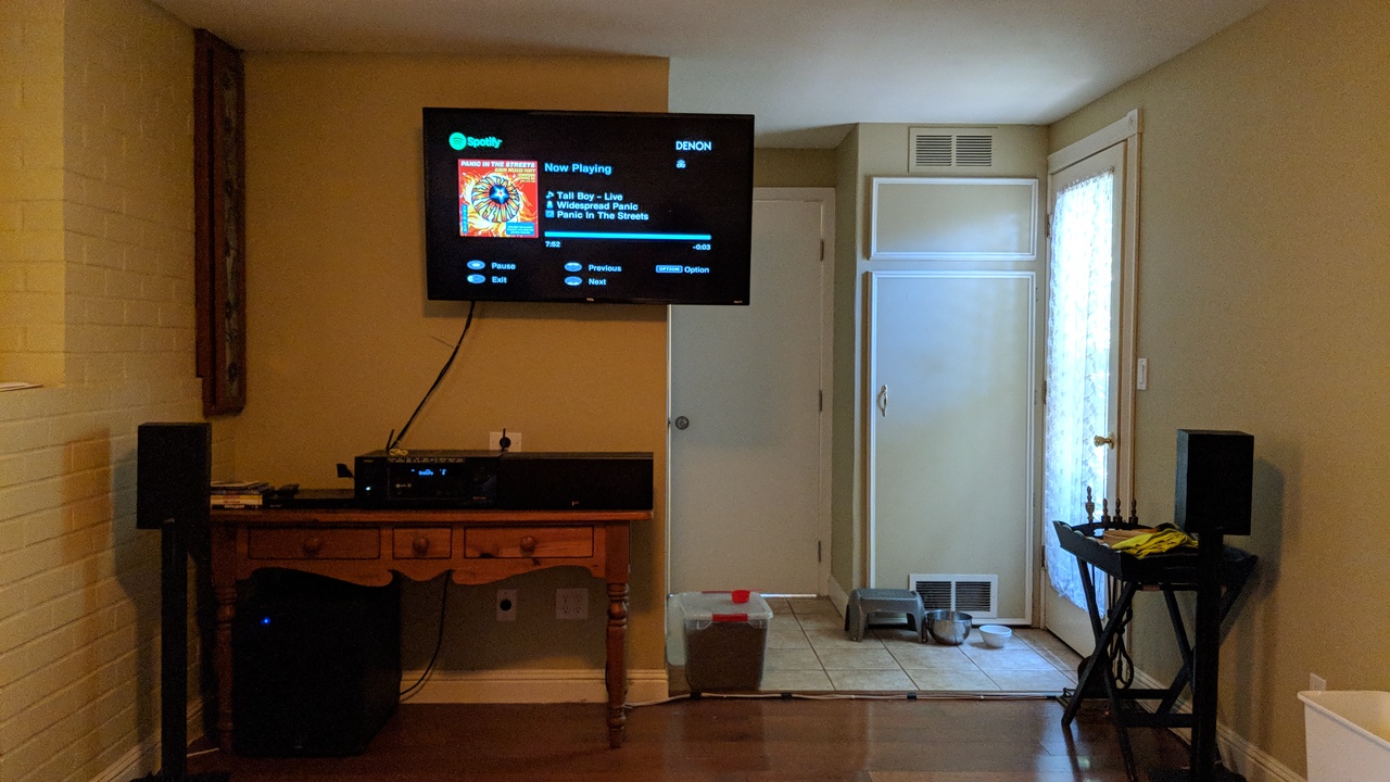

I'd say the center is maybe 4" to 6" below ear height. My dialog level adjust goes +/- 12db and I usually have to have it +9db to +12db depending on the film. FWIW, I exclusively stream via Netflix, Prime, HBO Go, etc. Just haven't started going down the BluRay road. Tried to do my best to get the cc under the screen via an articulating mount
I'd say the center is maybe 4" to 6" below ear height. My dialog level adjust goes +/- 12db and I usually have to have it +9db to +12db depending on the film. FWIW, I exclusively stream via Netflix, Prime, HBO Go, etc. Just haven't started going down the BluRay road. Tried to do my best to get the cc under the screen via an articulating mountView attachment 24723
Oh dear! Just about everything wrong with that picture. Do you have another location?
You have the right and left right up against the side walls one brick and the other sheet rock.
The center has a wall behind on the left and open space on the right. That really is a hopeless case if ever I saw one.
Quite honestly if that is your only option, I think a sound bar would be a better bet. That ambient field will be total chaos and I can understand why you have poor voice clarity.
We seem to run into this a lot now, with people installing AV in spaces that are totally unsuitable and where a cheaper simpler solution would likely be better.

I both appreciate your replying to my post and find it completely unhelpful all in one. In response to what you said here are some possible solutions that perhaps you could help me out with:
1) Buy me another house;
2) Explain to my other half why we should move our baby into that room since her room has better acoustics;
3) Hire a contractor and pull the permits to get this room up to your specs- and gift me the cash or just give me an open ended zero interest loan to get it done.
Any of these sound like doable options from your standpoint? If not, how about simply saying that I ought to just keep the dialog level adjust on and set it as high as I find necessary?

I'm just trying to explore if you have a better location. You only showed one end of the room. What is at the other end of the room? I find it hard to believe that is the only location possible. We often help people to choose a better location. That is the cheapest of upgrades we ever advise. I can see you spent significant cash on your system. That is why it is such a pity to have it hobbled right at the starting post.
So more pics may make it possible to advise a better layout.

Can you post a pic of the other side of the room?
Agreed. I hate to admit it, but I've been guilty of that myself. I'd have it set in my mind where my TV should be, but if I only moved it to an adjacent or opposite wall, then boom, problem solved.
I don't know what OP's room is like, but it's definitely a question worth investigating.
I also agree that his room is going to be a challenging one. However challenges like this one can often be overcome with a bit of creativity. I'd also like to know more about OP's room to see what advice we can offer up.
I'd also be curious where you might put this elsewhere in the room. If not possible, you might experiment with the center's position a bit to see what might improve it. Maybe try putting the center on a make-shift stand centered in the room more (disregard the tv's position) and pull the L/R speakers in a bit to see if that is an improvement. I know you may not be able to keep them there due to traffic in the room, but might give you some improvements outside of changing speaker level....

Here it is. The choice of a) putting in a pull out couch and b) putting the TV on that nice, long blank wall are not mine to make. This is our guest room, which accommodates guests perhaps 3 weeks out of the year.:rolleyes: If we end up living here for the foreseeable future (not a given), I'll take the wall the TV is presently on all the way across and put a door in there. That would allow me to bring the right front off the sidewall. As it stands right now it's not an option in the immediate future. The center channel is 4in. off center in the room, btw. More immediate plans include dampening/anti-vibration measures as the two subs get the room shaking quite a bit.
The house is a 3bd/3ba. We don't have space for a dedicated theater room, and neither the living room or family room are an option- something we both agree on.

I thought I'd see a couch for for reason. :) I had a room like that. I think you should get a couch on the brick wall side and put the TV on the other side. I'm figuring you have 8-12(mine was 10) feet there? Also get a rug to put the speakers wires under the rug for the back speakers. I'll look to see if my photobuckets pics for my setup are still there and post them here.
