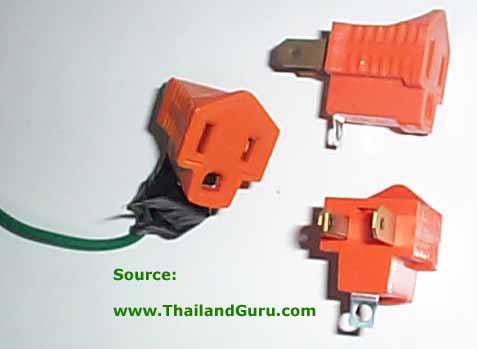

What I think what a “cheater plug” refers to is a ground plug adapter where you plug in a 3-prong cord connector into one side and the plug makes a 2-prong connection into the wall socket. The adapters I have seen also have a green ground wire which you hook onto the receptacle plate screw. If you have a ground problem, then I believe you “cheat” by not connecting the ground wire. These adapters are sold in the electrical section of Home Depot or Lowes and they are only a buck or two. Some people just cut off the power plug ground but that is not advisable if you ever want to sell that piece of gear because a lot of people want the equipment in original condition. If this is not what blinkthis69 is referring to he or someone else will need to clarify,

Haven't used one of these in forever, but I think this is what he's referring to:
I would think that would correct the ground loop.
