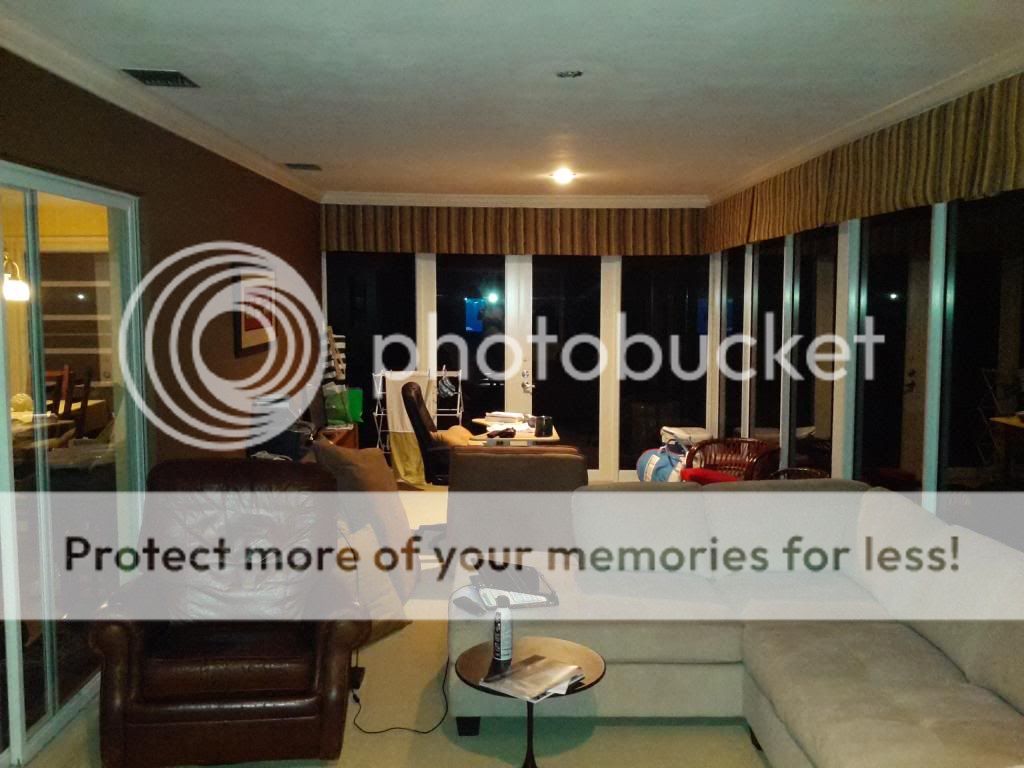

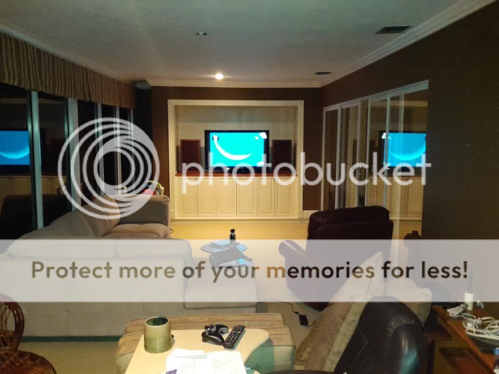

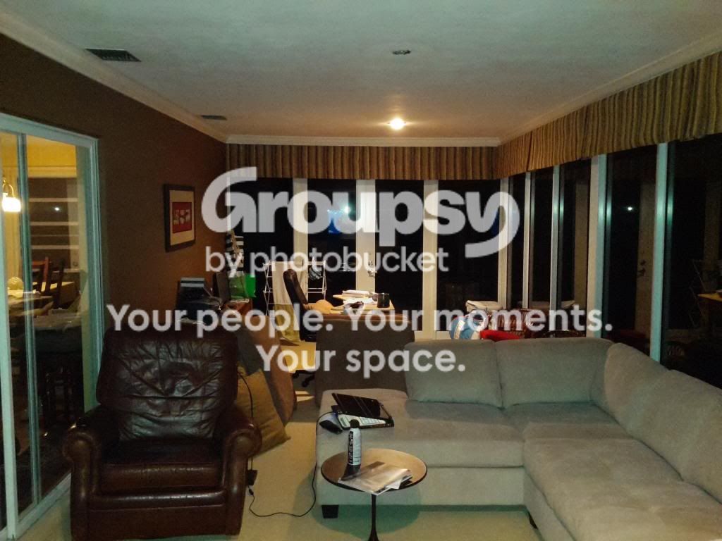

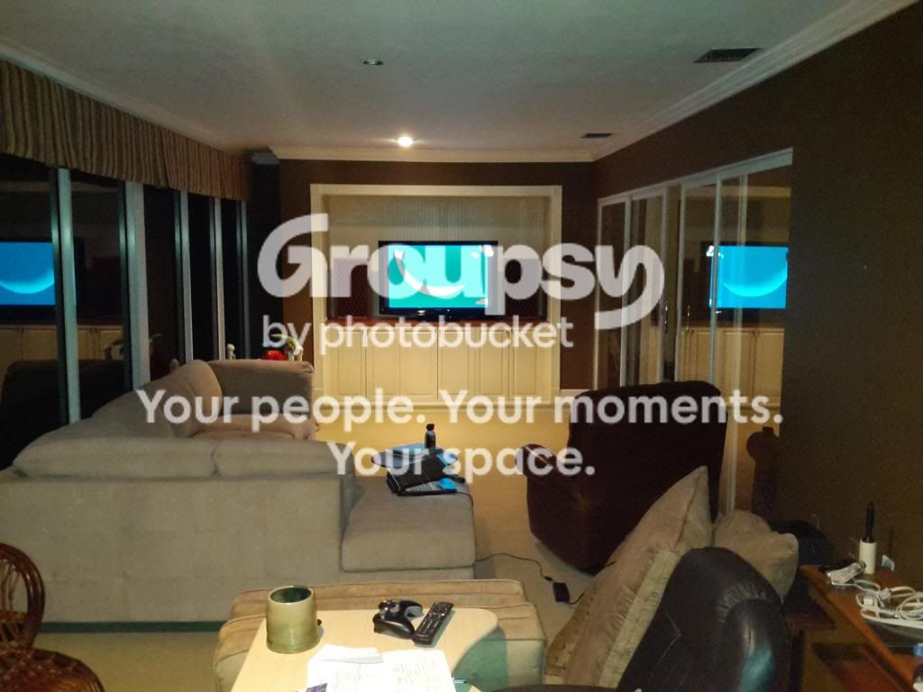

The room this is going in is 13'x27'. A/V equipment will go in built-in area shown in pics. The surround is hollow plywood construction as much as I can tell. Sub fits perfectly in niche to left of built-ins on the floor. Carpet floor over concrete. Floor to ceiling windows to left are impact glass.
View towards back of room. Planning on installing rears above back of seating area.

Now, I'm not going to say how to do things, but there is no way in the world I would keep the speakers where they are. They are to close to the TV and far to close to each other for good stereo imaging in your long skinny room. That nook was built for a TV, and the TV you have in there right now is way to small. I would be putting speakers towards the corners on speaker stands to open up the stereo imaging and I would pick up a cheap wall mount from Monoprice for your TV to raise the TV up some and to allow for a center channel to be placed on the shelf under the TV. Float the TV and get the center where it should be... and start saving for a 65" or larger display.

The TV is a 50" plasma in what I consider an unfortunately huge and deep nook. I wanted to avoid making the TV any higher and the nook is really deep and I feel like a wall mount option would be awkward. I suppose it could be telescoped out? Hiding wires would be a problem. I'll get dimensions tonight. To replace it with the LED I'd like (because of all the daytime light and glare in the room) it will at least double my budget. I suppose there's always Vizio, but I don't have confidence in their products. I'd really need to go with one that is rated for fighting glare. LG is the leader there right now, I believe.
I just threw the floor speakers up there to get them out of the way, they're not even hooked up and I want to use them in a 2 channel set up in my living room. My plan was to put much smaller book shelf speakers at the edges of that opening. My original plan was to put in Speakercraft MT Two's in the narrow columns on either side of the nook, but I'm afraid the install would be too complex and require rear housings, so I'm resigning to book shelves. But I take your suggestion seriously. Might need to consider new towers with a 7 month old just starting to move around the floors.
