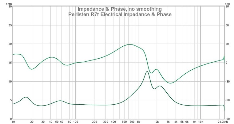

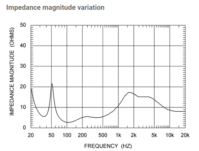

I don't want to hijack this thread, but I find this interesting and wanted to learn. Case in point the Sopra 2 is rated at 8 Ohms but has extened dips below and as low as 3.1 would not really be considered an 8Ohms speaker?
Where the Perlisten R7t is much more flat and I think is rated at 4Ohms
So the PerListen would be better compatiable with the MAC7200?
- Sopra Measurements taken from SoundStage Network Speaker Measurements
- Perlisten taken from our own Shady J
Yes, definitely. :)
The Sopra is NOT an 8 ohm speaker, that is a lie. Yes, the Perlisten would be the easier load.
