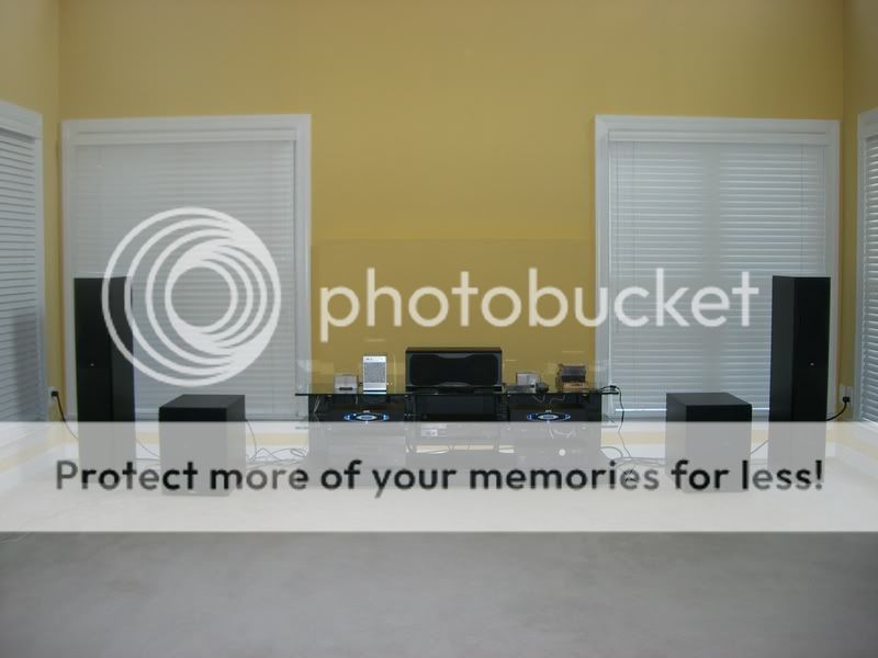

Update: Pics
Just thought I'd post up a pic of the set up. Haven't bought the tv yet - I'll mount the center speaker on the wall above it.
Gear:
Mains: RBH 1266SE/R speakers
Center: RBH 661 SE/R speakers
Surround/Rears: RBH 44 SE
Subs: 2 x Axiom EP 500 v2
Amp: Parasound 5250
Pre-processor: Acurus ACT3
DVD: Denon 2910
Music Server: Sonos + NAS
no. 5
no. 5
That looks very good, it sounds even better doesn't it? :cool:
