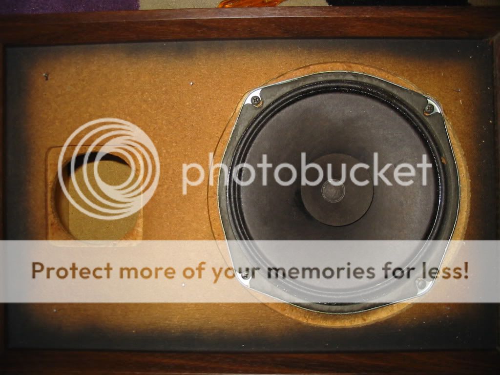

Hmm.. Not quite what it looks like. I'll post a picture in a moment, if I can.
I
iliekmuffinz
I hate to do this, but I just need one more post and I can put a picture up.
I
iliekmuffinz
Definitely looks like something is missing. And taking a closer look, the speaker that's there doesn't look very good.

That doesn't look very pretty.
It looks like someone may have swapped the drivers. See how the recess that the woofer is mounted in is circular, but has been relieved a bit where the top left and top right corners of the driver frame sit? It looks like on the top left one the mdf is lighter (as in more recent) than for the rest of the recess. You'll have to verify that by looking at the real thing.
Either this was a very cheap speaker to start with or someone has stripped it!
It is hard to tell what is in the center, but find some music with a triangle and see how full or loud it sound compared to mid range music.
As far as the missing element, that could be where a tube for the port is mounted or where a tweeter was (if not coaxial).
KEW
KEW
I thought of how to be certain about whether the speaker is coaxial. Look into the hole with a flashlight. Find the crossover. If there is no crossover or if there are only two wires (a positive and a negative) going from the crossover to the driver, it is not a coaxial speaker.

The woofer seems to have been changed and the origional tweeter
seems to have been taken out - that looks like a 2" cone tweeter
hole - since the specs state a crossover.

I only see two wires (positive and negative).
And if it helps, the hole in the other one is completely square. I'm convinced someone did a lot of altering on these guys.

I found one link talking about an agreement between Maximus and Curtis Mathis to provide commercial audio-video systems.
If the original speakers were good quality, I could see some kid in an empty conference room swapping out drivers during a night shift and replacing them with the cheapest thing they could find.
Let us know if they sound as bad as they look!

It looks like it may be an old RadioShack full range whizzer cone speaker,
that was put in there.
