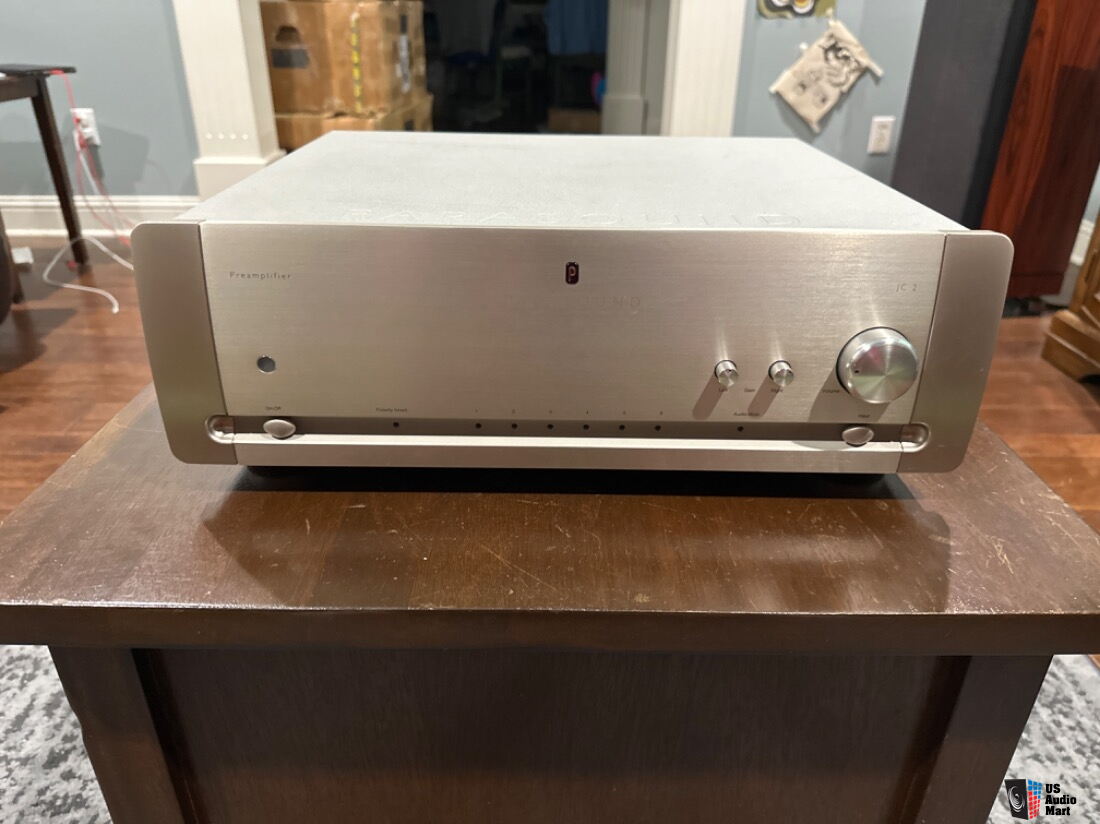

If specs and measurements are not important to you since distortions of just about any >$1,500 preamps are low enough to be in the so called below the human hearing threshold, then just choose based on features, perceived build quality, reliability record, and the look, style, feel etc., they will all "sound" great with your power amp. Just make sure you get one that can output high enough voltage for your listening habit, or best, high enough to drive the Purifi amp to its rated output, and with ample reserve, just for future proofing in case your listening habit change, and/or speakers change in the future.
There are many preamp choices, but for the caliber of the Purifi amp, you really want to pair it with a preamp that has at least 5-10 dB better specs so that it does not become the bottleneck. I am suggesting preamps such as those by the reasonably prices Parasound Halo or Classic that people often would recommend are not as good in terms of sound quality for real world use, but those amps typically have specs and measurements that show they will be the weak link when paired with the likes of the eval-1 eigentakt purifi. Again, weak link only in terms of measurable performance on paper.
The supporting objective reviews are there, such as the following:
Comparison can be made not just SINAD (THD+N), but also in other measurements such as IMD, SNR etc.:
I use the JC2 as the example because it is Parasound's flagship preamp, models below it will likely not measured as good, though again, may not sound different either.
Parasound JC2 Preamplifier Review | Audio Science Review (ASR) Forum
