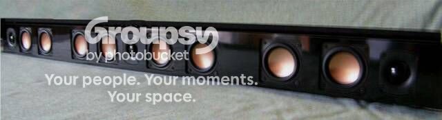

I presume you are interested in a bar for aesthetic reasons? As a sound bar or in-walls are a compromise and are not going to deliver the best audio typically. That said, if you are already considering Outlaw (probably LFM-1 Plus, not EX for that room, but EX wouldn't hurt :) ) Perhaps you could consider their new sound bar so you can get the whole thing in one shipment? Outlaw Audio OSB-1 Sound Bar

The Outlaw SoundBar is an Atlantic Technology clone.

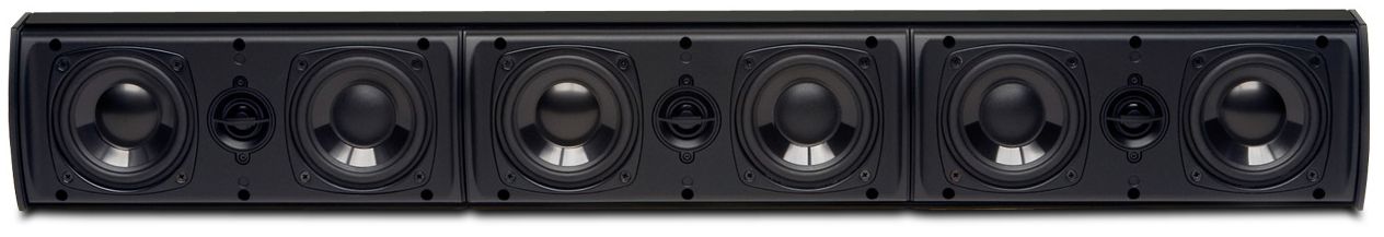

If you need to go SoundBar - then look at the P400 3-channel passive
soundbar - that way processing can be handled by a receiver > which
can be more positive - and mate it with an Outlaw subwoofer
BOSTON ACOUSTICS P400 Soundbar Speaker Black NEW | Accessories4less

With the Boston passive SoundBar - you can control the 3 channels seperately.
