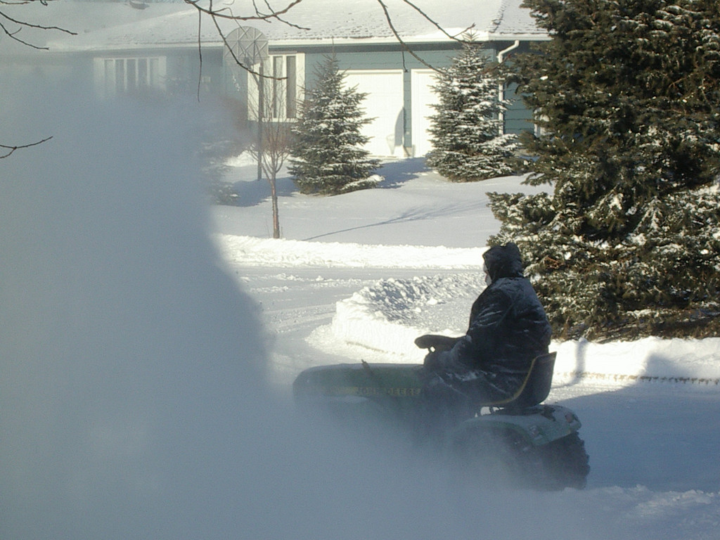

I love this topic. Course, anything that turns dead dino's into noise and other kinetic actions is all right by me. I am also looking out the window at the 1/2 inch of snow in the yard from yesterday. still there and should last through the day due to the cold temps.
My favorite snow removal device was a JD utility tractor with hydrostat transmission, loader, and a 6 foot blade for the 3-pt on back. That easily cleaned up my 300+ft snaking uphill driveway in Iowa. But I don't live there anymore. But it was my favorite. It is also total overkill for your application. But that 72" mower deck and 32 hp diesel engine made short work of the lawn and could handle just about any size snow drift I threw it at...even the shoulder high ones I had to wade through to get to the barn.
When I moved to Wisconsin, I ended up with a used 24" 2-stage Jacobson snowblower from my fil. It worked good right up to the point it chucked the piston rod through the case. I replaced it with a 24" Ariens two-stage 8 hp model 824E snowblower. OH MY GOD does that thing throw snow!! That thing chucks the snow a good 40-50 feet away and churns through it all. I've run it through drifts taller than the front chute and it didn't miss a beat. My only issue is my driveway is about 150 feet long and is a gentle curve of about 70 degrees whose width starts at 3 cars wide, necks down to about 1.5 wide and then widens to about 2 cars wide. So I end up pretty much fighting the snowblower through a constant gentle turn the entire time plus a bunch of extra cuts at the front and back of the drive. Really want to use a shovel to smack the guy that designed this driveway. It is a royal pain in the arse! The snowblower is powered so that isn't the issue, just the fact I have to keep it constantly turning since there isn't a straight section anywhere on my drive. Seriously, you won't go wrong with an Ariens. They have a great reputation for a good reason. It's why I bought one as I didn't want to mess around with the cheap off-brand crap at the big boxes.
If you go with a two-stage snowblower, buy and keep extra shear bolts on hand. These are the bolts that connect the front augers of the first stage (slower rotating at the very front that dig into the snow and feed the snow into the machine) to the driven shaft so they rotate. They are designed to break to protect your gear case and other expensive items. I usually fail one or two every winter. So I always keep extras on hand. They are easy to replace. Just haul the unit into some light, knock off the snow, use a screwdriver or a hold punch to line up the bolt hole with the hole in the shaft and clear out any ice/snow in the hole, and then put a new bolt in there and tighten it up. Don't over tighten so it clamps onto the drive shaft. Easy, simple repair. For the sake of the lawyers, shut the engine off first before making the repair or you may lose a finger or two.
My current lawn/snow combo is a Kubota GR2010 lawn tractor with a 48" mower deck and a 42" snowblower. I went with this combination for a couple of reasons. First, the lawn tractor is 4-wheel drive so it is less likely to get stuck on ice than your rear-wheel drive big-box tractors. Second, it is shaft drive for the mower deck and snowblower. No messing with belts or pushing it back to the garage when the belt breaks. Third, it made it easy for the wife to clear snow when I was traveling for work. Nothing sucks worse than trying to clear the driveway after the snow has had time to harden into blocks of ice...especially where the plow goes. Spending two hours outside trying to clear up the mess and break up the ice blocks at the end of the drive totally sucks. So no excuses now, the tractor does all the work and even has power steering (hydraulic).
Am I lazy? Hell yes! My crappy shaped driveway took a good 45 minutes with the walk behind snowblower just cause of the really odd shape. I'm 15 minutes tops with the tractor including warm up time for the engine. If my driveway was straight so it was easy to make simple up and down passes, I would still just use the Ariens two-stage. My wife hated fighting it around the constant curve so she wouldn't clear the snow. She would just pack it down into ice with her Subaru. And I got to try to clean that up or wrestle the snowblower around those ice humps. Sucks!
It's worth it to get a high quality brand for a snowblower.
