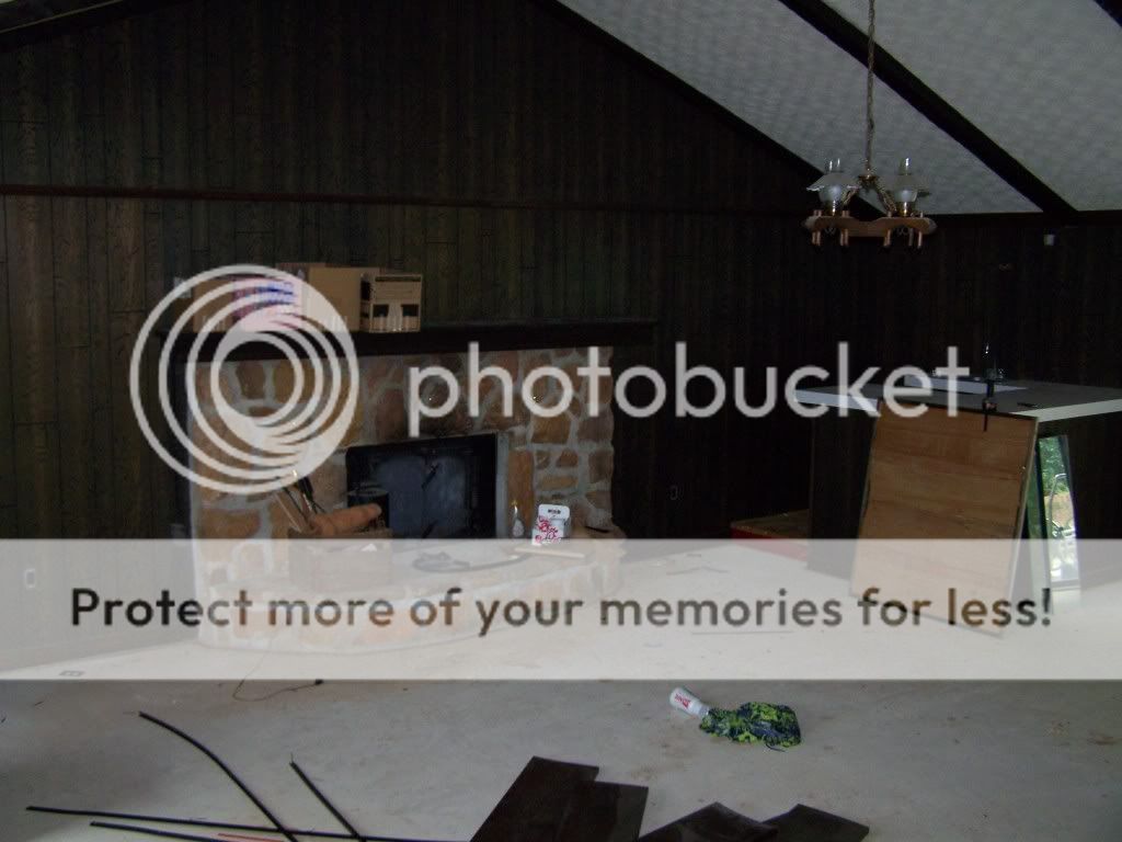

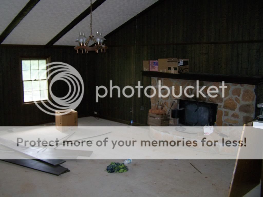

Here are two photos of the room. The house was just purchased and we are doing a complete remodel. The fire place will be stacked stone to the ceiling. There is also a slider to the back yard that you can’t see in front of the bar. There are two doorways in to this room one on either side. The pictures were taken from those doorways. The wall opposite of the fire place is blank with nothing on it. The bar on the right side is going to stay there.

That fireplace is a hot smokey wood burner. You absolutely CAN NOT hang a TV above that. It will be too high anyway.
Lets Have a look at the other end of the room. A blank wall sounds good!

The fire place will still get hot, so that end of the room should be ruled out right away.
