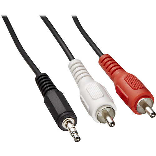

I have been trying to get my laptop connected to a rotel rb1050 amp via headphone jack using the mm to rca cables.It doesnt work for whatever reason.Even tryed different speakers to see but no dice.Headphone jack works as i tryed headphones just to make sure.Could use the help.similar to these.Thanks
