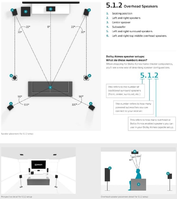

I would go to the sides, just behind the listening position and angled towards the LP. Also keep them at, or just above ear level.
Basically like this.
