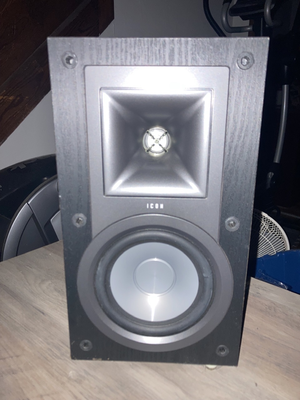

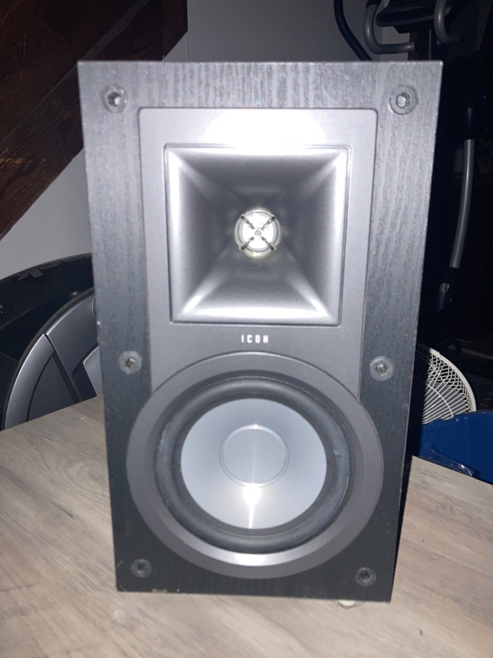

Old thread but these pop up on Amazon $279 I assume new but they cost more then rp. Prob should have looked into them back then.
And are Even older then my icons only 5” woofer so . I figure they would not have a warrenty even if new. Just interesting as the size driver is retired in the brand for bookshelf speakers. Did you ever hear them are they any good ?
