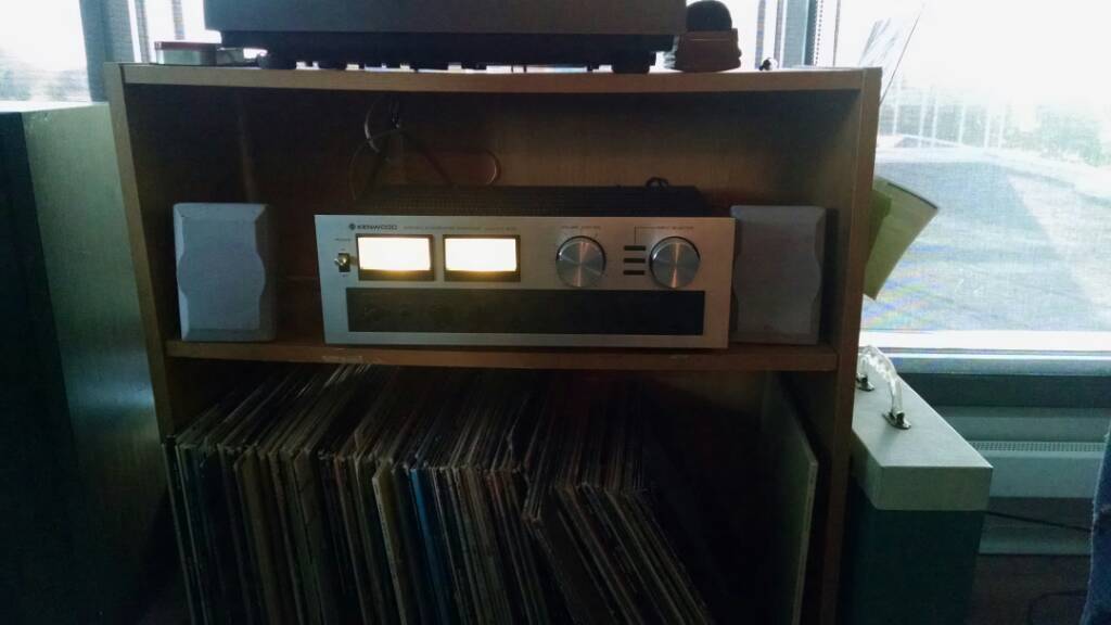

Hi everyone! I'm new to the forum, but I've been a long time lurker.
I have a late 70s Kenwood KA 405 receiver that I've had for about 5 years. I got it from a friend who was going to throw it away because the input and monitor switches were REALLY scratchy and causing the sound to cut in and out.
I got some deoxit and cleaned all the switches and pots, and found a set of really nice mint Kenwood JL 850 speakers for next to nothing (A side) and a couple heavy 4" speakers I already had (B side), put some LEDs in the burnt bulbs,and it's been working and sounding like a million dollars since....
Except that now over the last few weeks it's been popping or snapping intermittently over both channels. I've put it on only the A channel, only the B channel, only the left, only the right, loudness on and off, power amp set to "direct" and "tone on" and it pops no matter what I do. The sound doesn't cut out, at least not noticeably, and the power meters jump when it pops on both channels.
Am I about to blow a cap or is my amp going out or what?
