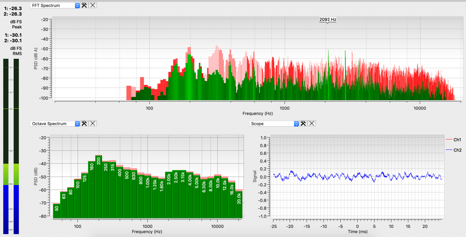

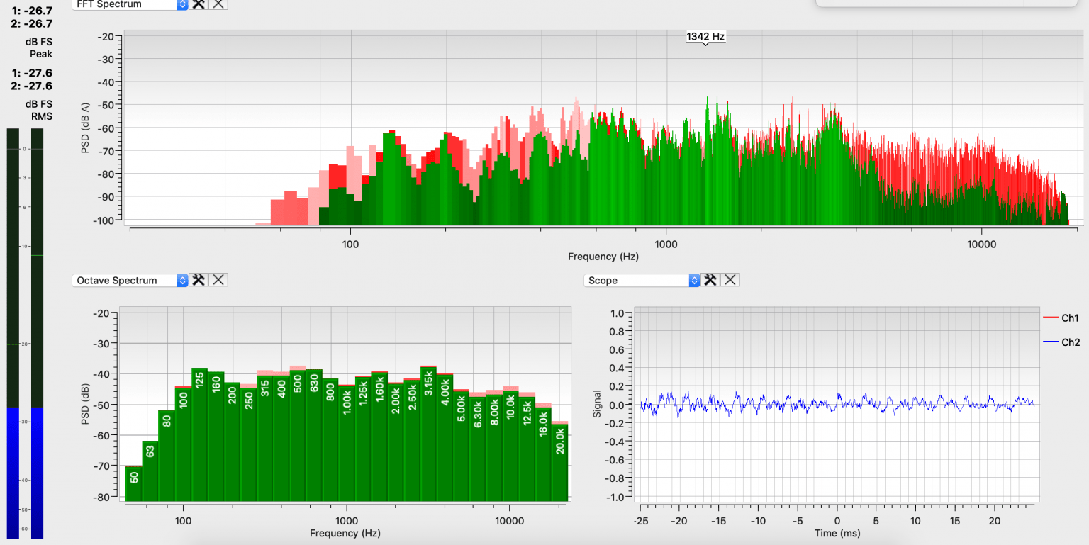

The blue is an upgrade. The red has is an elliptical diamond tip on a metal shank. The blue has a nude elliptical diamond mounted to the cantilever.
The tip mass of the blue is less than the diamond/metal combo. It is also significantly more rigid.
The result will be better transient response. The FR of the blue is marginally more linear. FR of the red is 20Hz to 20KHz +3/-1 db. The FR of the blue is 20Hz to 20KHZ +2/-1 db.
A diamond tipped stylus versus a Nude diamond, is a definite benefit in favor of the nude diamond.
Here is an analysis of a transient from and actual LP of the red versus the blue.
The red.
The Blue.
Note those are not FR graphs, but an instantaneous spectrograph if an instant transient and NOT a steady state sign wave.
That improvement will be audible, and it won't actually be that subtle.
The analog world is quite different from the digital world as far as increased precision in the mechanics of the play back system has significant sonic improvement.
The take home is that increase in build quality and therefore cost does bring real improvements.
This is a forum where it seems to me few members have experienced really high end analog sources, both disc and tape. The results of higher end systems are far superior to the run of the mill. If you were in my room, you what be astonished at the quality of the analog sources, even the gear that is half a century old or more. The major difference is the time, effort and expense required to achieve that level of quality compared to current digital sources.

Nice but still doubtful as to such audibility differences, altho the medium/playback systems have serious problems in general....
Especially a simple change of stylus assembly....but the magic is often in the consuming rather than the actual experience when it comes to vinyl.

I could not disagree more.
First of all in an MM cartridge the really important elements are in the cartridge assembly. In an MM cartridge, the stylus assembly contains, the stylus, cantilever, suspension, damping and the small moving magnets. The body, is just that, and only contains the fixed coils in which the small magnets move and the wiring. The stylus assembly is 95% of the loaf at least.
It is clear to me that you are not versed in the science, engineering and mechanics of disc reproduction. You are opinion can therefore not be a valued and considered opinion.
