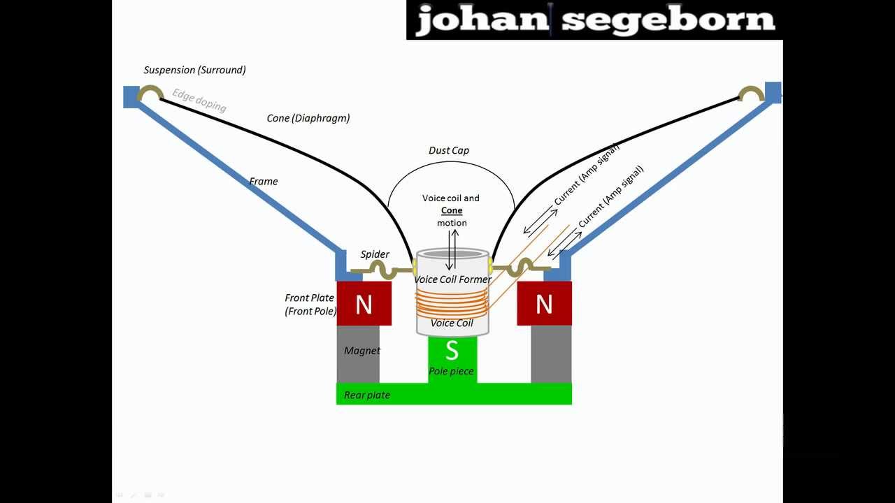

Look at this diagram.
So you can see the bottom/rear plate has shifted with respect to the top/front plate. So since opposite poles attract, the center pole is held fast against the front pole with extreme magnetic force. So the south pole has actually become detached from the North pole and is held by magnetic force. If it were not for the opposite poles attracting then the back of the magnet would have fallen off.
